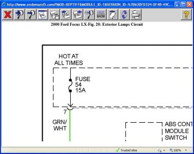

2000 Ford Focus Need to know what wire is for fuse 54
MATTHEW.MORAN

I really need to know what wire goes to fuse 54 and what wire exits. I have to wire up a new fuse for it since mine melted. A wiring diagram would really help, since I need to piggy back it with another wire to share the constant power in. I know what needs to be done I just dont know what the wire's color for the wire that leaves that fuse. This is very important because my sister in law is driving with my nephews with out brake lights or her instrument panel.
We had already taken it to a shop, they put a new fuse in which then melted into the box. I found the damaged wires that grounded out and repaired them. With that problem fixed all thats left is the fuse box(quoted 350 for a new one) this is the only solution she can afford ($16).
Either way the wire color code would be great but the diagram for that part of the fuse box would be even better. Namely for fuse 54 and a fuse that accepts the same wire in.

https://www.2carpros.com/forum/automotive_pictures/416332_2000_ford_focus_fuse_54_1.jpg
There you go.

Can you tell me another fuse near 54 that is also hot all the time. I will need that to add in the other fuse.

First of all thank you so much for your donation. Can I get the 8th digit of your vin so I can get you the correct information.
