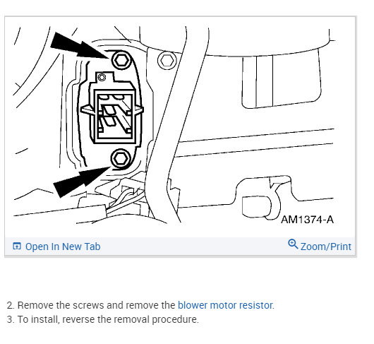

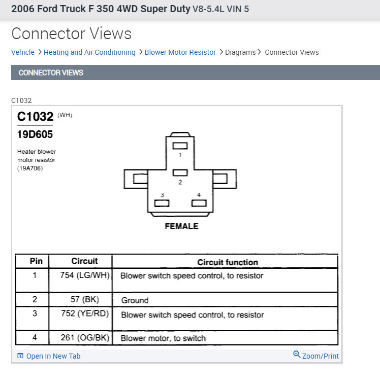

It does sound like the issue is a bad blower motor resistor.
Typically, when the blower resistor fails it only allows one speed and no other setting functions.

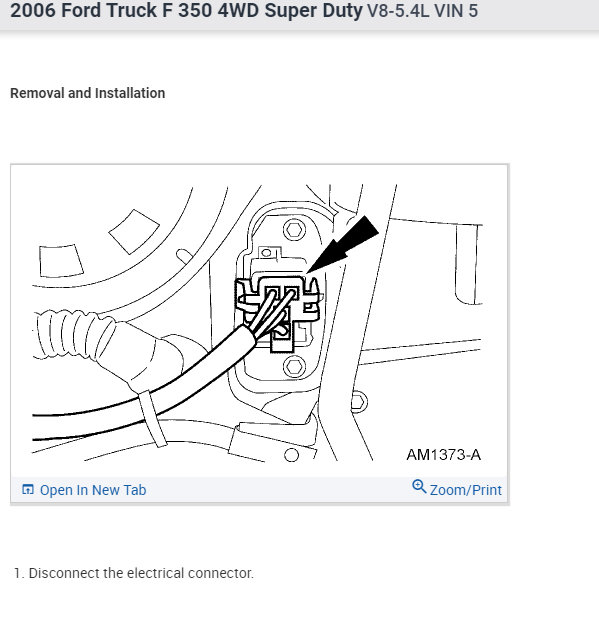

That resistor is located in the blower motor housing. Which located on the passenger side fire wall. This can be access from under the hood.
