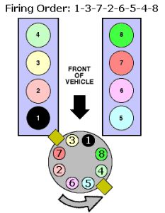

i recently pulled the distributor cap, and the spark plug cables off one side of the engine to keep my skank girlfriend from taking the truck, like a jackass i didnt label anything as to how it went back together... i cannot buy a repair manual because i am broke, my problem is that i cant get the cables in the correct spots on the distributor cap....is there anyway someone could get me a diagram of the wiring from the distributor cap to the spark plugs so i can drive this thing again?

Here ya go.... The pic below is for 5.8 Liter Engine
https://images.2carpros.com/forum/automotive_pictures/188069_96f35058_1.jpg
The pic below is for 5.0L and 7.5L
https://images.2carpros.com/forum/automotive_pictures/188069_96f35075_1.jpg
