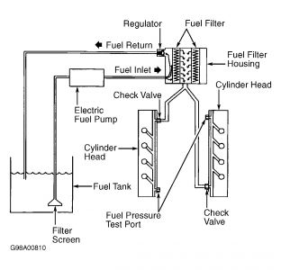

Checked for leaks and found one just under or around the fuel filter on top of the engine. Doesn't seem to be the O-Ring seal for the filter itself but there is two what seems plastic assemblies attached to the fuel filter housing where it seems to be coming from. Can you help me solve my problem?

I think you mean the fuel lines ? check they are fully clipped into place ??
https://images.2carpros.com/forum/automotive_pictures/266999_fuel_7.jpg

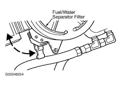

There seems to be 4 screws securing the drain plug your talking about and the leak seems to be coming from there.

this diagram is of the drain ... check the lever is closed correctly ? is this where the leak is from ??
https://images.2carpros.com/forum/automotive_pictures/266999_drain_2.jpg
FUEL FILTER WATER DRAINING Release fuel system pressure. See FUEL SYSTEM PRESSURE RELEASE . Allow to drain for approximately 25 seconds or until clean fuel is observed. Close drain valve by resetting handle to its original position. Close hood and remove container from under vehicle. Dispose of waste fuel properly.
