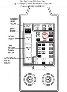

When I shift to drive or from drive to park it blows the instrument and gas pedal fuse. How do I fix this?

Hi Daryl , Thank you for the donation. I need to confirm the fuse that is blowing to understand the problem better. Is it Fuse # 15 ( Red circle in diagram)?
https://images.2carpros.com/forum/automotive_pictures/192750_CentralFuseBox01F250Fig03_2.jpg
Jun 25, 2010 at 5:43 AM
DARYL HOLLINGSWORTH
No, it's number 19

Since the fuse only blows when the gear shift is moved, I believe there is a short to body between the Tan/White wire of Transmission control Switch (TCS) and the PCM, terminal # 29.
Unplug the PCM and TCS and test for continuity of Tan/White wire to body. If continuity is present, the wire is shorted and you have to locate the source.
