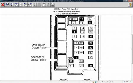

The accessory delay relay, once engaged, would not quit until the window reached the bottom, even when interrupted by the switch. That or something else has either burned out my window motor or created some other problem, making the driver's side window inoperable. I did shuffle relays to check. All the same. Passenger side window still operable.

There is also a relay for the one touch for the drivers window, but replace the BOO and see what happens, did you disconnect the deacivation switch?
You may need to have it scanned for codes, even if the dash light is off you may have "B" codes stored, the truck has a DDM(drivers door module). Last, have you replaced any light bulbs lately? I will get back on this at 2:00 pm After work, test you door window switch....

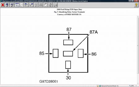

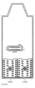

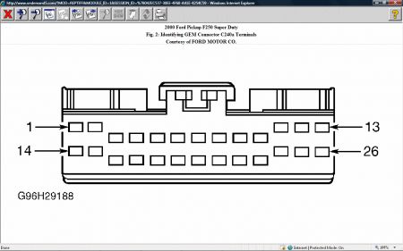

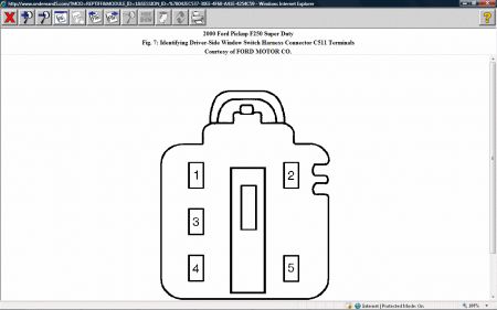

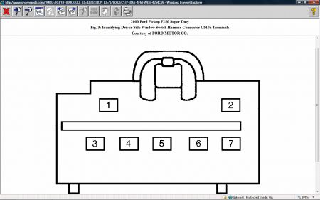

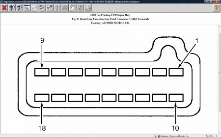

Here are the connector pin ID's
https://images.2carpros.com/forum/automotive_pictures/62217_Ford_Consa_1.jpg
https://images.2carpros.com/forum/automotive_pictures/62217_Ford_Consb_1.jpg
https://images.2carpros.com/forum/automotive_pictures/62217_Ford_Consc_1.jpg
https://images.2carpros.com/forum/automotive_pictures/62217_Ford_Consd_1.jpg
https://images.2carpros.com/forum/automotive_pictures/62217_Ford_Conse_1.jpg
https://images.2carpros.com/forum/automotive_pictures/62217_Ford_Consf_1.jpg
https://images.2carpros.com/forum/automotive_pictures/62217_Ford_Consg_1.jpg

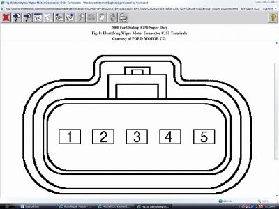

WIPER MOTOR
1. Disconnect negative battery cable. Disengage linkage from motor. Disconnect wiper connector. Connect in-line ammeter between negative battery terminal and wiper motor terminal No. 3 (Black wire). For mating connector view, see Fig. 8 . Connect a jumper wire between positive battery terminal and wiper motor terminal No. 4 (Black/Light Green wire).
2. Observe ammeter and note low speed current draw. If current draw is greater than 3.5 amps, replace wiper motor. If current draw is 3.5 amps or less, disconnect jumper wire and go to next step.
3. Move jumper wire to wiper motor terminal No. 5 (Light Blue wire). Observe ammeter and note high speed current draw. If current draw is greater than 5.5 amps, replace wiper motor. Fig. 8: Identifying Wiper Motor Connector C151 Terminals Courtesy of FORD MOTOR CO.

Well, I finally got by the parts store and bought a wiper motor and window motor. I went out after dark with my little headlight on and replaced both. Wipers still don't work and I now have another window motor with down side burned up!
Wipers on fuse #11
Speed control & stop lights on Fuse #13
Power windows on 30amp Breaker, position 25 in the power distribution box under hood.
