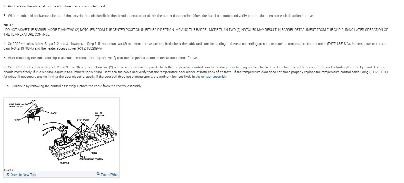

Greetings, owner complained of no heat. Thermostat was replaced as was heater core. Both lines to the core feel hot. The blend door next to the heater core appears to be functioning properly. I s there another control in the duct system to direct more air into the heater core? Thanks

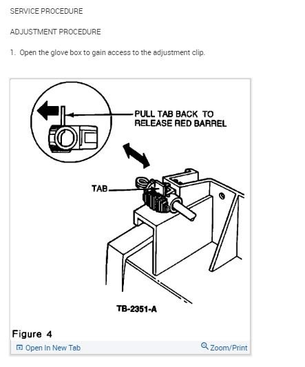

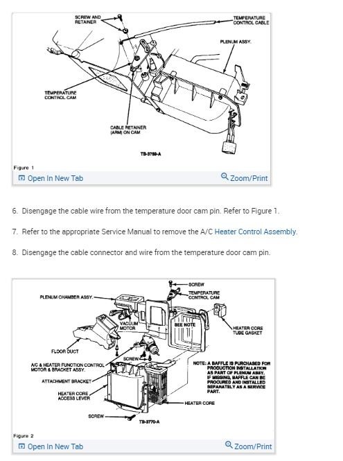

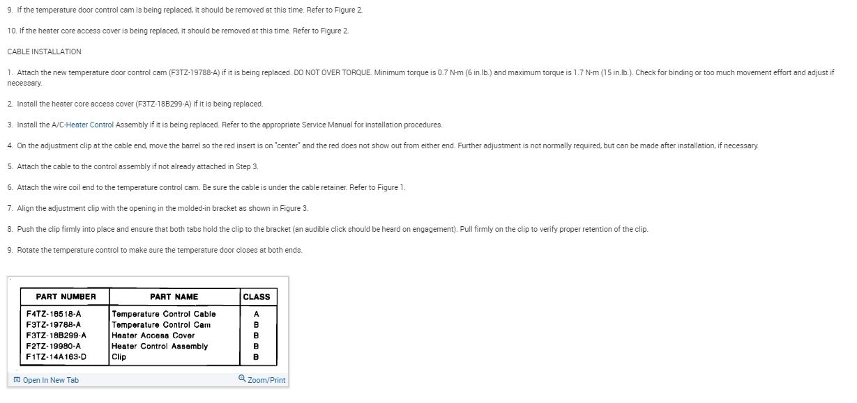

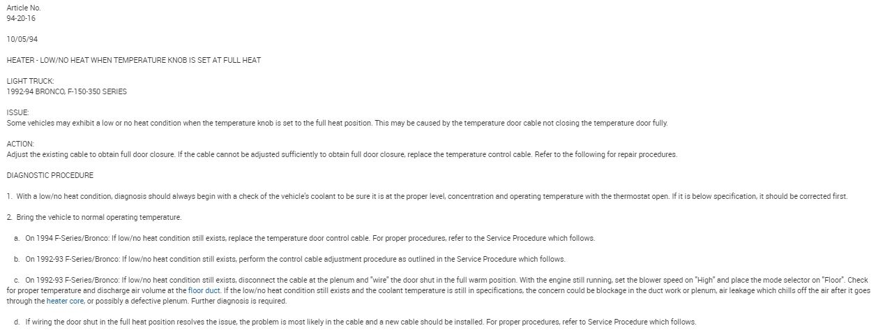

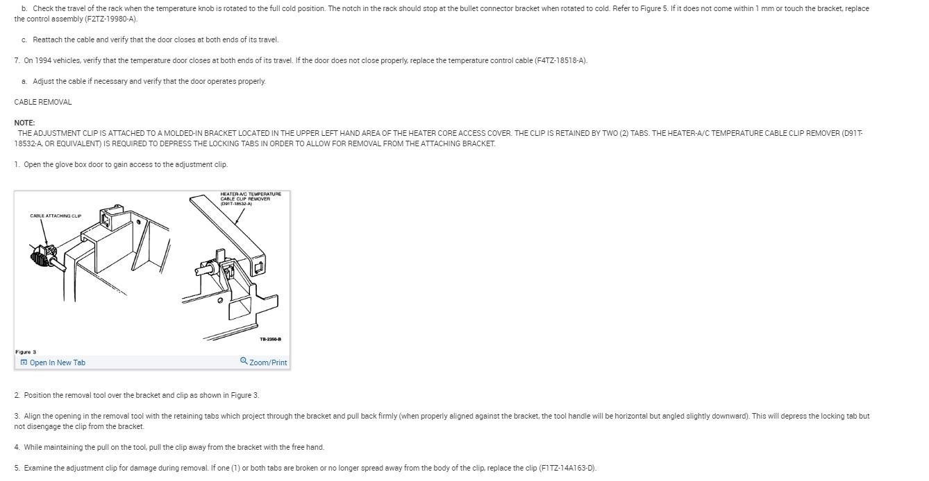

There is a tech bulletin on this,It is attached below and guide
Check out the diagrams (Below). Please run this test and get back to us.

Thanks for the info on the blend door cable. I removed the 7 screw cover for access to the heater core. After moving it both with the cable and without it did not appear to close completely. I used a hook shaped screwdriver and was able to reach in and rake the bottom of the plenum next to the door. I heard a rattle and was then able to squeeze my hand in and discover an ink pen apparently had fallen through the defrost and blocked the door from complete closure. After removing the pen and reassembling the door the heater now functions properly and blows 125 degree air.

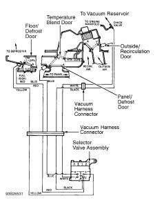

I have a heater in the pickup that will not blow warm air into the cab. The thermostat is good and the heater core warms right up and the front passangers feet will get warm fast. But if I try to use the defrost or thed vents all I get is cold air. I have looked all over for debris and I have checked the electrical system. What do I do its cold here and I have small kids.

FUNCTION SELECTOR VALVE
Place function selector knob in specified position. Using a vacuum gauge, check for presence or absence of vacuum and compare to VACUUM DISTRIBUTION table. If test results are not as specified, check for kinked or broken vacuum lines. If vacuum lines are okay, replace function selector valve. See Fig. 1 .
VACUUM DISTRIBUTION
Selector Knob..Outside/Rec.. Panel/Def..Floor/Def
Position.............Door...........Door..........Door
OFF...................V.................V..............V
FLOOR..............NV...............NV.............V
VENT................NV...............V.............NV
MIX...................NV..............NV............PV
DEF..................NV...............NV............NV
Vacuum (V), No Vacuum (NV), Partial Vacuum (PV).
https://www.2carpros.com/forum/automotive_pictures/266999_vac_6.jpg
