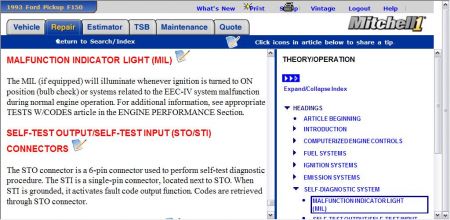

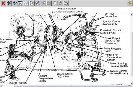

How do I look for a code on 1993 f-150 it has 213508.5 miles and has a 5.0 engine :lol:
Wednesday, October 31st, 2007 AT 2:08 PM
MECHANIC
75,992 POSTS
See below
