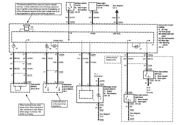

MHPAUTOS
  • 31,937 POSTS
The gauge has probably been damaged, sometimes when they see a voltage spike or the such it sends the gauge past its working parameters and they will get stuck there.
See the diagram below for the wiring you need to check as well as the guide on how to use a voltmeter to test the gauge
Let us know what you find
