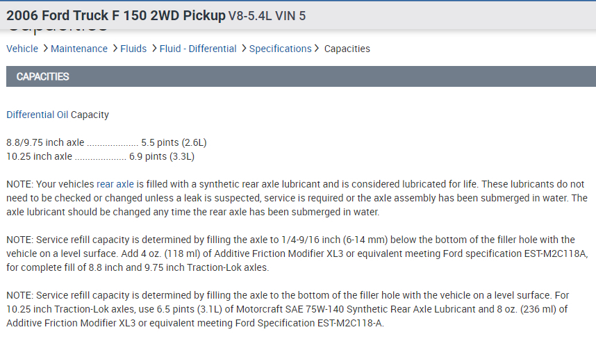

How often does the rear differential fluid need to be changed?
Jul 11, 2008 at 1:29 AM
DANNY L
  • CAR REPAIR CONTRIBUTOR
  • 5,648 POSTS
Hello, I'm Danny.

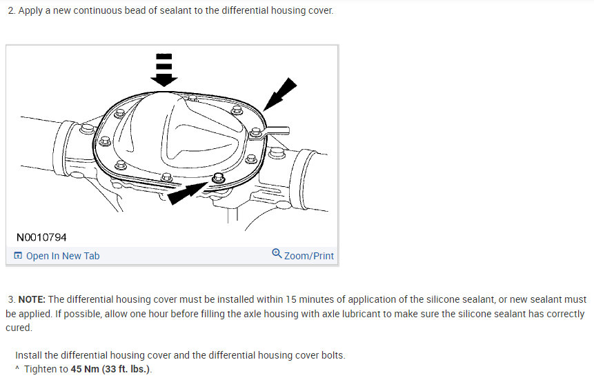

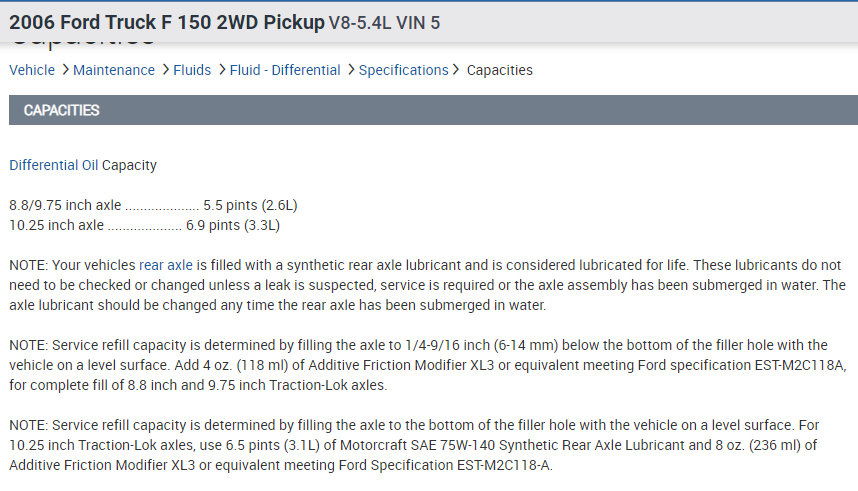

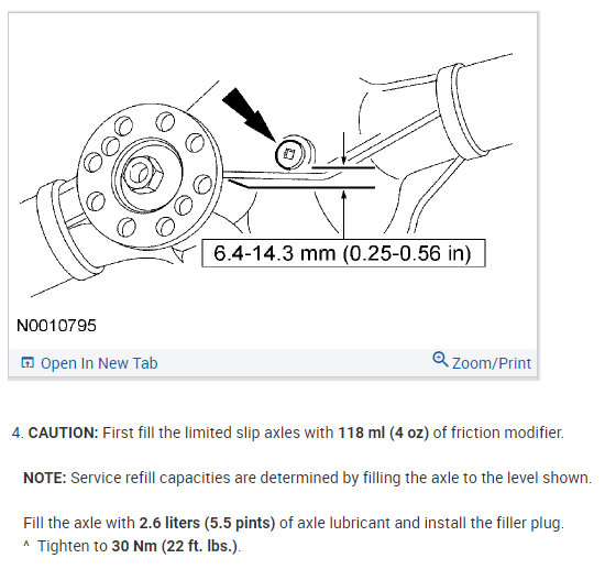

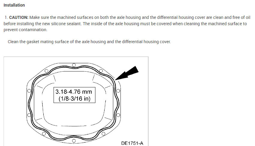

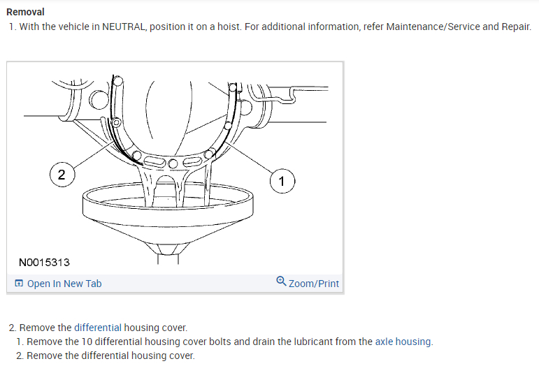

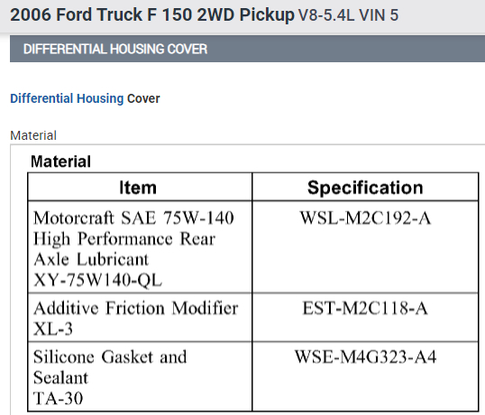

Here is the information you requested. The service manual shows that the rear differential oil is recommended to be changed at 150,000 miles. Here is a tutorial showing how to change differential gear oil:
https://www.2carpros.com/articles/differential-service
I've attached picture steps below on how to change the differential gear oil including the recommended type. Hope this helps an thanks for using 2CarPros.
