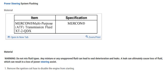

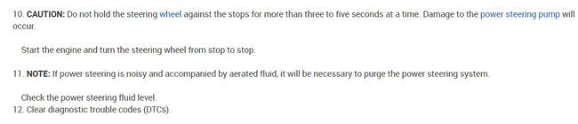

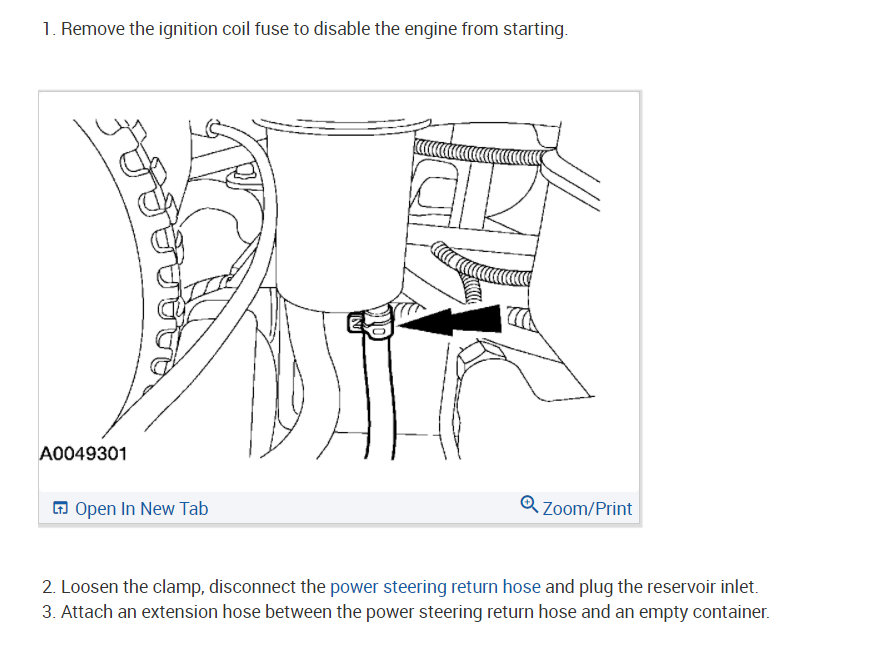

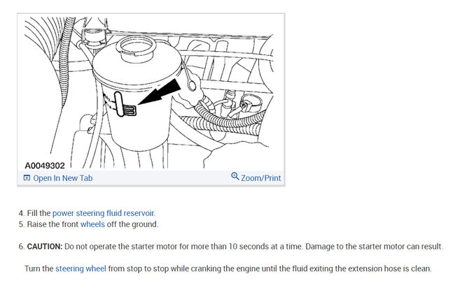

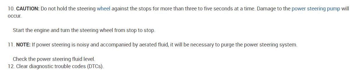

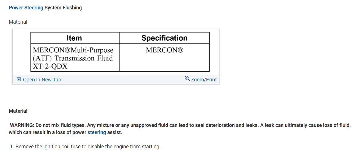

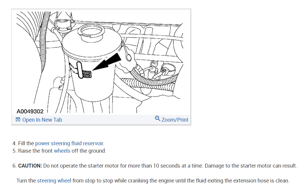

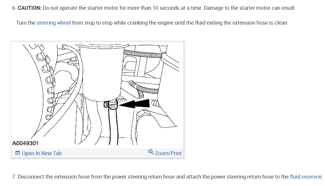

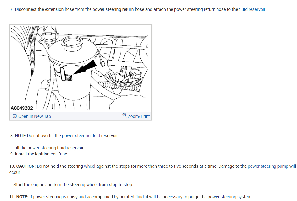

Power steering intermittently stops to work (steering wheel stiffens up but still operational) we want to flush the system can you help?
Wednesday, August 27th, 2008 AT 2:51 PM
  • 52,797 POSTS
Good afternoon,
I attached the procedure for you below for the flushing. Make sure you use the correct fluid or you may damage the seals and cause a total loss of power steering.
https://www.2carpros.com/articles/power-steering-fluid-flush
You may have to do this several times to get rid of all the old contaminated fluid.
