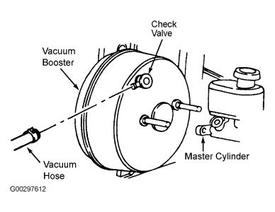

I recently purchased an'03 F-150 Harley with a bad motor (truck has less than 10,000 mi. but motor was locked up). In moving truck around brakes worked good (hard pedal of course = no vacuum), but brakes worked & released good. Installed new motor, got everything running good so I decided to see if it would move itself, & brakes won't release. After lots of trying different things we figured out that as soon as the engine starts the pedal goes down & stays (holding brakes on). If I un-plug vacuum line to booster brakes release instantly (with or without motor running).
Can someone tell me if this is a bad booster or could it be in the ABS pump?

I would be looking at the check valve being jammed up first ? Brake Booster Both models are equipped with a dual-diaphragm vacuum booster. The power brake booster is a dual diaphragm, vacuum assisted power brake booster. The booster reduces brake pedal pressure and travel distance. The booster is located on the left side of the bulkhead in the engine compartment, between the brake pedal and brake master cylinder. The booster is divided into separate chambers by the diaphragm and will not operate if vacuum is restricted or if any of the vacuum related power brake components fail. The brake booster is replaced as an assembly. If the power assist fails, the brake system will continue to operate with increased brake pedal effort. See Fig. 4 . The power brake booster check valve is located on the front of the power brake booster. The check valve is positioned between the power brake booster and the power brake booster hose. It closes when the engine is turned off. In the closed position, it traps engine vacuum in the power brake booster and retains vacuum to provide several power assisted brake applications with the engine off.
https://images.2carpros.com/forum/automotive_pictures/266999_valve_2.jpg

I guess I should have been more descriptive. I have very strong vacuum on booster sidde of valve & valve is working, when I un-plug valve from booster (with engine off) I still have vacuum . My brakes are appling & holding themselves. I just don't know if the problem is in the booster or the ABS pump. The ABS pump (as all parts) is so expensive I hate to change parts I don't need to.

** Problem Solved ** Bad Booster **
Never seen this before, I seperated master cylinder from booster, & when I held vacuum hose to booster it would extend plunger (thus, appliing brakes) & when removed plunger would retract (releasing brakes). Replaced Booster & brakes work perfect. Every booster I have ever seen fail would do just the opposite, pedal would be very hard & feel like very little brakes.
