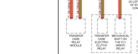

When driving at times my F-150 would start jerking for a couple of seconds, around 30-40 mph. I had the transmission flush and service there was no problems noticed.
The 4x4 will not engage. I turn the knob to 4x4 L or High and nothing happen. I have check and tested all the fuses they were ok.
need help please, thanks you

Hi Preston Hester Jr., Welcome to 2carpros and TY for the donation.
Jerking problem: check the fuel pressure, clean the MAF sensor with an electronic cleaner CRC and test throttle position sensor
As for the no 4WD: check fuse no.104 30amp if okay one of the following below is causing your problem
http://www.2carpros.com/forum/automotive_pictures/12900_relay_and_module_1.jpg

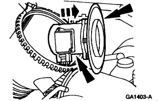

I'm sorry but I know very littler about vehicles. Where do I find the MAF sensor. Thanks
Friday, October 15th, 2010 AT 9:29 PM
  • 75,992 POSTS
Its in the air cleaner
http://www.2carpros.com/forum/automotive_pictures/12900_maf_1.gif
