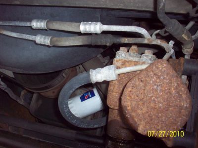

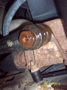

i noticed a noise last night in my power steering.. I stopped to check and seen the fluid just pouring out. I put more in and seen that it was coming from a little box that is located under the engine near the axle. the box has a big nut or bolt on the bottom of it??? i would like to know what the name of the price is thats leaking and any suggestions of what can be done to stop the leak?? thank you

BERGA1234
im pretty sure this is where the fluid is coming from??

KHLOW2008
  • 41,814 POSTS

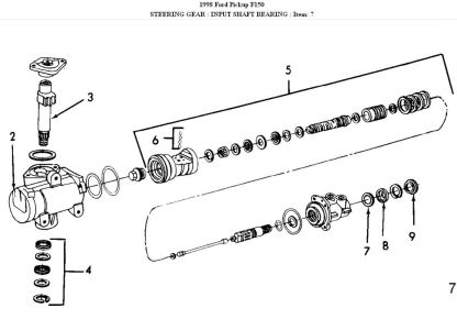

Yes, that is the steering gear assy and the item that causes the leakage at the lower part is the oil seal. The labor time for removal and overhauling it is 2.7 hour as yours is a 2WD.
https://images.2carpros.com/forum/automotive_pictures/192750_SteeringGear98F150_1.jpg
Item #4 is the part that is leaking, it is known as the sector shaft kit.
