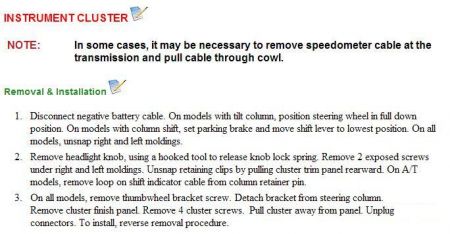

Left side of dash lights are out need to replace

Will have to pull out instrument cluster by following steps below to access and replace the gauge bulb(s)..

That is a very good reply, the bulbs should be part number 194 if that helps. Jeff
