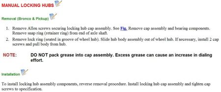

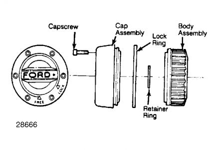

HOW DO I REMOVE HUB ON 4X4 MANUAL OF FOR F-150 TO CHECK BEARINGS?
