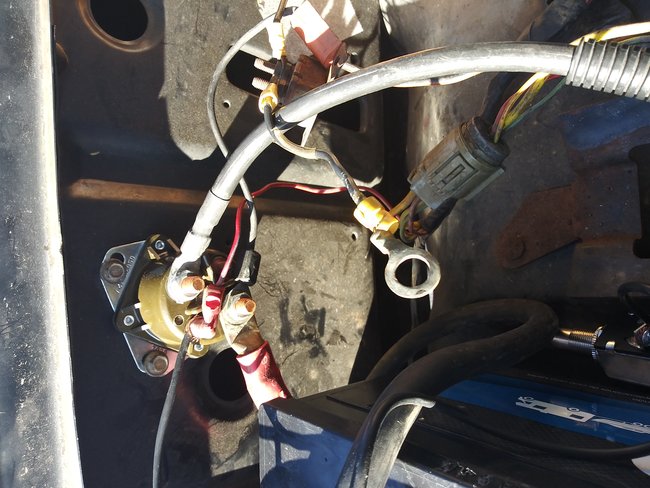

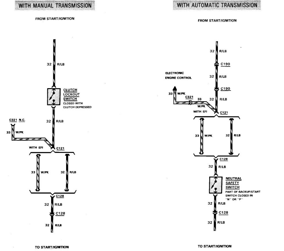

Greetings, I bought a 1986 f150 stepside 302, AOD trans. The wireing from the battery through the starter solonoid was disconected. Cant figure out how to get power to the ignition, accessories ect. Could you tell me what wires go to the battery side of the solonoid. It is the factory wireing harness but one wire had been cut at one time with an aftermarket conector but sliced to it, a black wire.. Thank you.
+1
Tuesday, December 31st, 2019 AT 12:30 PM (Merged)
OBXAUTOMEDIC
  • 3,711 POSTS
How many wires are on the relay solenoid?
There should be on the side going to the Battery a Green Fusable Link Wire which should turn to a yellow wire which is the Ignition Wire.
On the other side going to the Starter there should be a Blue Fusable Link Wire which turns to a Pink Wire with Black Stripe.
If this doesn't appear right, if you can take a pic and post it.
BLACKHAT89
Hello, thank you for the reply and you are welcome for the donation. Ok, I have four wires that I would like to point out to you. From the alternator harness one black/orange stripe #10 or 12 gauge with orange fuse link. From main harness, black/green stripe #16 with a plug in line. From harness, yellow #16 to black fuse link to black. From harness, yellow #16 to black fuse link to red or pink hard to tell with age of truck. From what you said in your message, it looks like the yellow to red is my battery side of the relay power wire. Do any of the other three also hook to the battery side?I also should mention the truck was built in Canada if that makes any difference in the wireing. Thanks a bunch.

OBXAUTOMEDIC
  • 3,711 POSTS
Sorry for the delay.
I don't have access to my today, I will take a look at the wiring diagrams and let you know. I don't think it being biult in Canada makes a difference.
Also are you able to take a pic and post it?

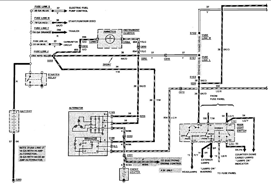

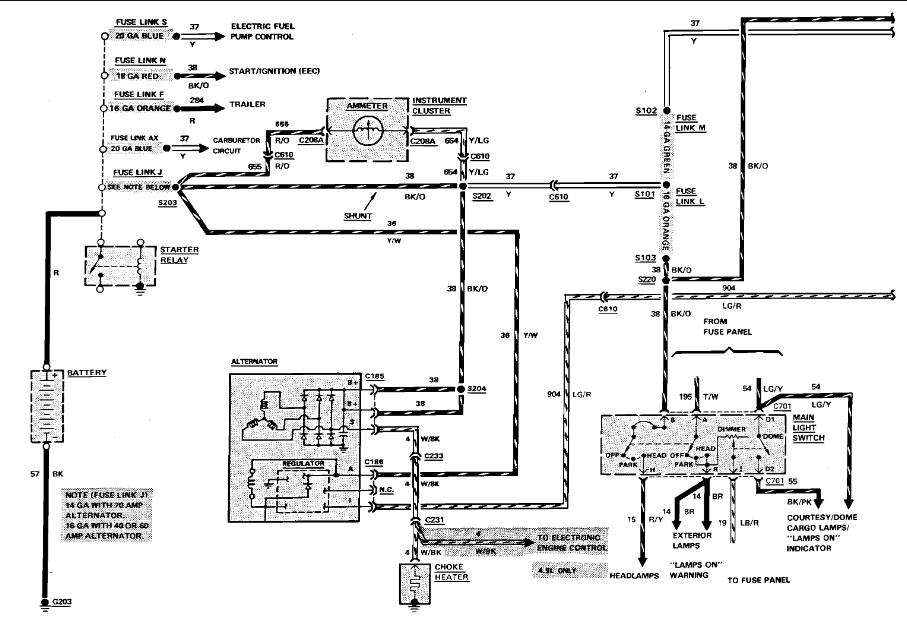

OBXAUTOMEDIC
  • 3,711 POSTS
This is all I could find that would show where the wires go.

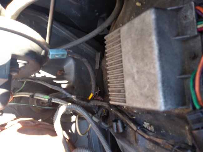

I need help someone yanked the wires all over the hood can anyone tell me where these wires go 86 f250 460 motor

DANNY L
  • 5,648 POSTS

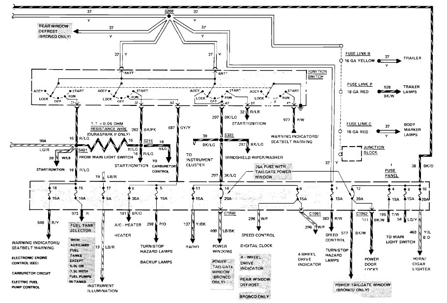

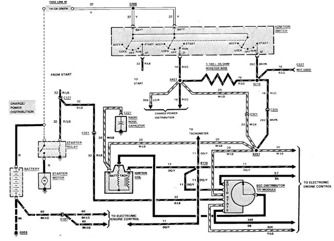

Hello, I'm Danny.
I've attached 2 wiring diagrams below. Hope this helps and thanks for using 2CarPros.
Danny-
