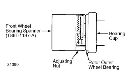

I have never seen a wheel lock nut like this it seems to be a cam type locking nut. What would the torque specifications be? It is a three piece unit made to be tightened by special socket tool.

I have looked at manuals but none show this one piece mechanical type lock nut. Hoping someone could tell me what the torque specifications is for this type.
The nut is in a housing with a inner piece that has gear type teeth. The outer piece also has gear type teeth and is threaded to fit on the spendle housing.
Need torque spec.

Using Spanner Locknut Wrench (T86T-1197-A), apply inward pressure to unlock adjusting nut locking splines and turn nut clockwise to tighten to 50-60 ft. lbs. (68-81 N.m) while rotating the wheel back and forth to seat bearing.
NOTE:When specified torque is reached, adjusting nut will no longer tighten. The threaded nut portion will ratchet in the assembly upon approaching specified torque. Continue tightening until the specified torque is obtained.
https://www.2carpros.com/forum/automotive_pictures/99387_Graphic2_180.jpg
Apply inward pressure and back off adjusting nut approximately 90 degrees. Retighten adjusting nut to 15 ft. lbs. (20 N.m). Final end play of hub on spindle should be .000-.006" (.00-.15 mm). Install hub lock and wheel assembly.
