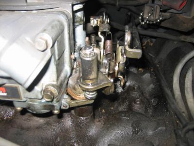

When accelerating from a dead stop, (like pulling out into traffic) the throttle stays open and and won't return when I let off the pedal so I have to either throw it into neutral or turn the key off. It only does this in drive. I can make this happen while sitting in drive with the brakes applied and then slowly giving it gas and then the throttle "catches". There are no throttle sticking problems with this holley 2 barrel carb. The return spring is tight. While in park there are no problems with it ever catching or stayng open. Also when cruising down the road I can accelerate suddenly with no problems and shifting is fine. The kickdown rod seems to be working properly (WOT). I have made adjustments to the vacuum modulator and the transmission responds like it should to these adjustments. Obviously this is a dangerous situation that I would like to get repaired, just not sure what. Thank You.

OK if you could include a pic of the carb without the air cleaner on it so I can see what all is there so I can help determine what the problem is that would be great. The throttle return spring should only be tight enough to close the throttle no more. If the return spring is to tight it will wear the shaft out and make it stick when it hits the worn spot and only do this when the return spring is hook up. Get back to me with the pic and we will go from there.

http://www.2carpros.com/forum/automotive_pictures/339553_IMG_3626_1.jpg
http://www.2carpros.com/forum/automotive_pictures/339553_IMG_3627_1.jpg
Does not seem to be a carb issue because it only happens when the transmission is in drive.

Ok if I see right there looks to be a vacuum hose under the throttle linkage is it toughing anything? Does there look to be any rub on it form the linkage? Next thing is are the engine mounts in good shape and not broken? How about the trans mount? Now this is an auto trans does any of the linkage going down to the pedal binding with any of the shifter linkage around or near the steering column? How about the bell crank at the end of the manifold is it in good shape and not groved? Get back to me with what you find and we will go from there.

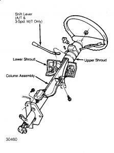

Have you jacked up the engine to make sure it isn't seperated? Have you checked the trany mount for the same? If it only sticks under pressure that means that the engine is moving enough to cause something to bind up. So if you would jack the engine up just a little and then move the lingage by hand and see what if anything is changing. It could be that there is a bad bushing in the bellcrank between the pedal lingage and the carb linkage and it pulls under engine lift.
Also if you can block the wheels and then with in not running put it in gear and see if anything from the shifter is moving to a point of getting in the way. The linkage at the end of the column may be getting in to just the right position that it is causing this. See the cam at the bottom of the column that moves as you probably know so check to see that is clearing everything and not binding with the lingage any where.
http://www.2carpros.com/forum/automotive_pictures/249564_Graphic_64.jpg
