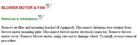

i need to replace my ac fan motor but how do i find it some people say its under the hood but it isnt i found the risistor pack under the glove box and replaced it is theblower motor under the glove box i dont see it thanks for any help

blower motor is on the right side of the engine compartment..
https://images.2carpros.com/forum/automotive_pictures/261618_Noname_2233.jpg
