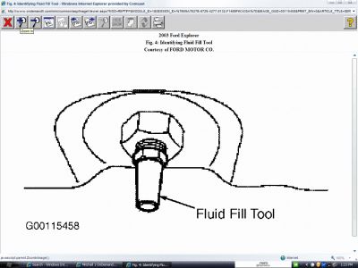

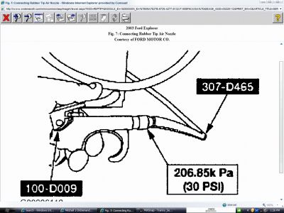

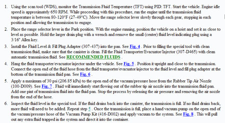

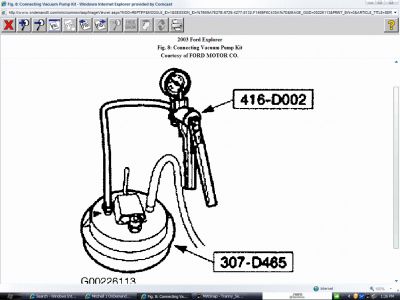

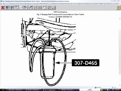

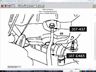

dear sir or madam ,
could some one please tell me where the exact location of the filler plug in the transmission is at on this transmission the owners manual say there is no dip stick and there is a plug on the transmission to add fluid but i am not sure where it is at please help thank you , mark minges

Believe it or not, this requires 3 tools to add fluid!
and one is the fill gun that uses compressed air to operate...are you up to it? I will post the exact proceedure if you really want it...

yes please can you show me or post what needs to be done

https://images.2carpros.com/forum/automotive_pictures/62217_Tranny_Servicea_1.jpg
https://images.2carpros.com/forum/automotive_pictures/62217_Tranny_Servicec_1.jpg
https://images.2carpros.com/forum/automotive_pictures/62217_Tranny_Serviceb_1.jpg
https://images.2carpros.com/forum/automotive_pictures/62217_Tranny_Serviced_1.jpg
https://images.2carpros.com/forum/automotive_pictures/62217_Tranny_Servicee_1.jpg
https://images.2carpros.com/forum/automotive_pictures/62217_Tranny_Servicef_1.jpg
https://images.2carpros.com/forum/automotive_pictures/62217_Tranny_Serviceg_1.jpg
