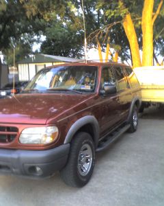

You cant hear the noise while in park,not even if u raise the rpm,I only experience it while driving.As long as I dont go over 30 mph I dont hear the noise,and if im driving on the highway,if I drive over 60 mph I dont hear the noise.I was told that it might be the smog pump,problem is there is no smog pump that i can find.Ive checked all the u-joints I had the tranny checked by ford and it didnt show any codes except the TPS and an open circut which i have not found.But I still havnt given up yet.
I'm going to check all my vacuum lines today with a propane torch(not lit of coarse)
https://www.2carpros.com/forum/automotive_pictures/559502_4X4_FORD_009_1.jpg
