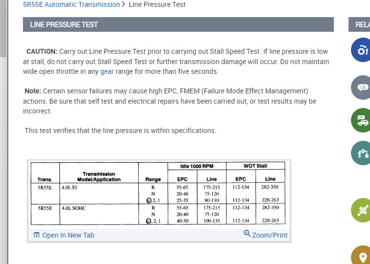

My 2000 Ford Explorer just the other day started up for me fine but when I went to shift it into Drive it did not move at all only revved up. I thought it was the transmission that went but now I'm confused because I heard when a transmission goes usually you can get at least one gear on it to work. This change came out of the blue really and I want to know why so I can bring it to the right place to get fixed. I heard it could be a converter or gearbox possibly? The cheaper the fix the better haha =]
Thursday, March 11th, 2010 AT 10:11 PM
When you have no gears at all this is a pressure issue in most all cases. There are times that the shifter is the issue but normally you can put it in manual 1 or 2 and get some gears.
So if you have no gears then that means we need to start with the causes of pressure issues. First is low or no fluid.
https://www.2carpros.com/articles/how-to-check-and-add-transmission-fluid

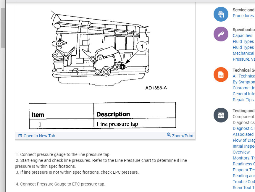

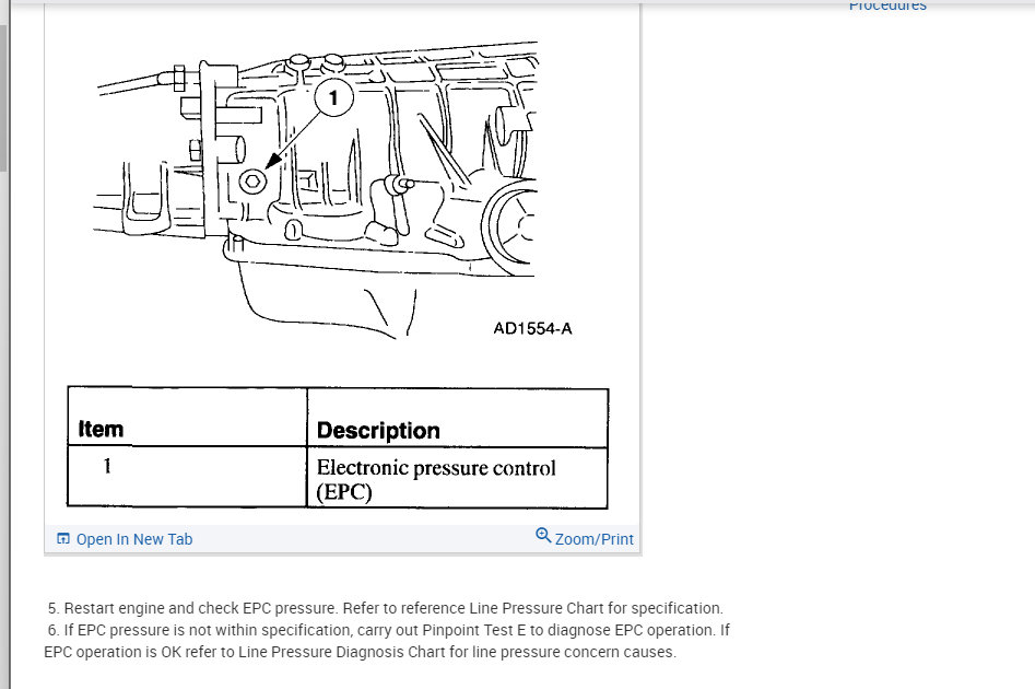

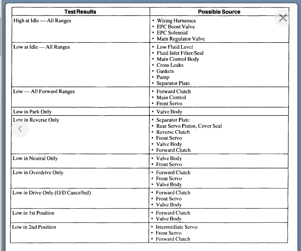

If the fluid is ok then we need to check the actual pressure because we have either a pump or a leak internally causing the pressure to no build.
If the pressure is ok but still no movement then that would point to a converter issue.
However, let's get the line pressure and go from there.
Please see the attached info and let me know what you find with this.
Thanks
