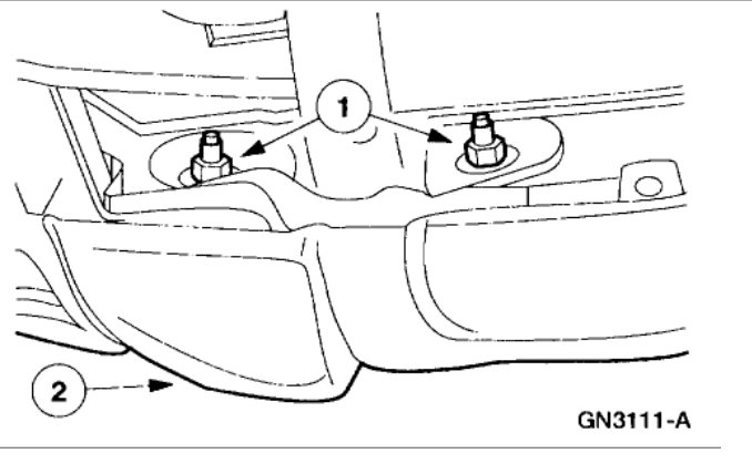

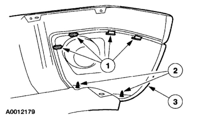

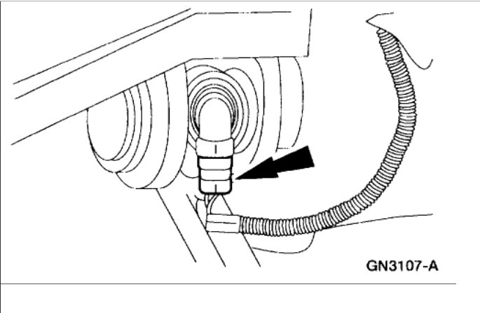

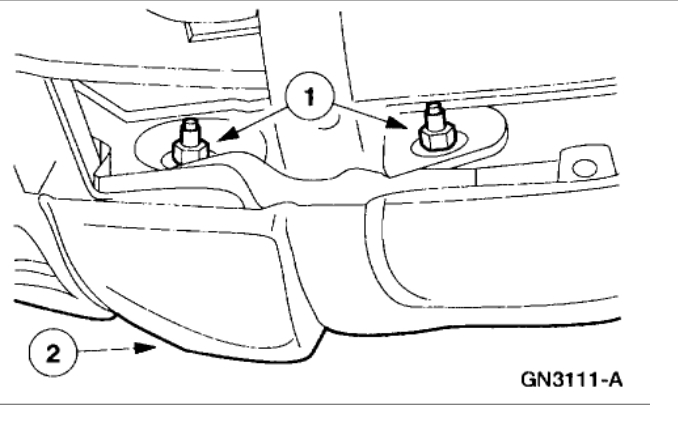

I got into a fender bender about a month ago. To fix it it would cost about 1900 dollars, more than I paid for the car itself. So I decided to replace the bumper myself. I have the new bumper but I cant seem to get the old off. Can anyone help or maybe give a link to a site that can? thanks in advance
Aug 2, 2007 at 9:52 AM
  • 55,423 POSTS
First you must undo the wiring leading to the lights then it is just a few mains cross bolts that need to be undone and the friend bumper will slide out. HEre are some diagrams (Below) to help you see what I am talking about.
