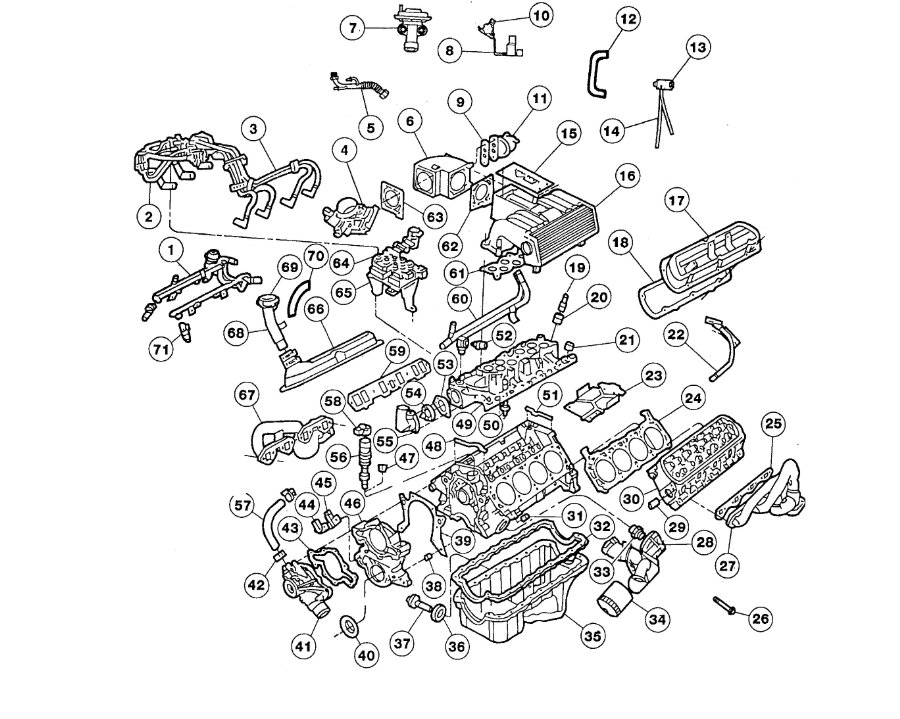

Where is the pcv valve located for this vehicle?

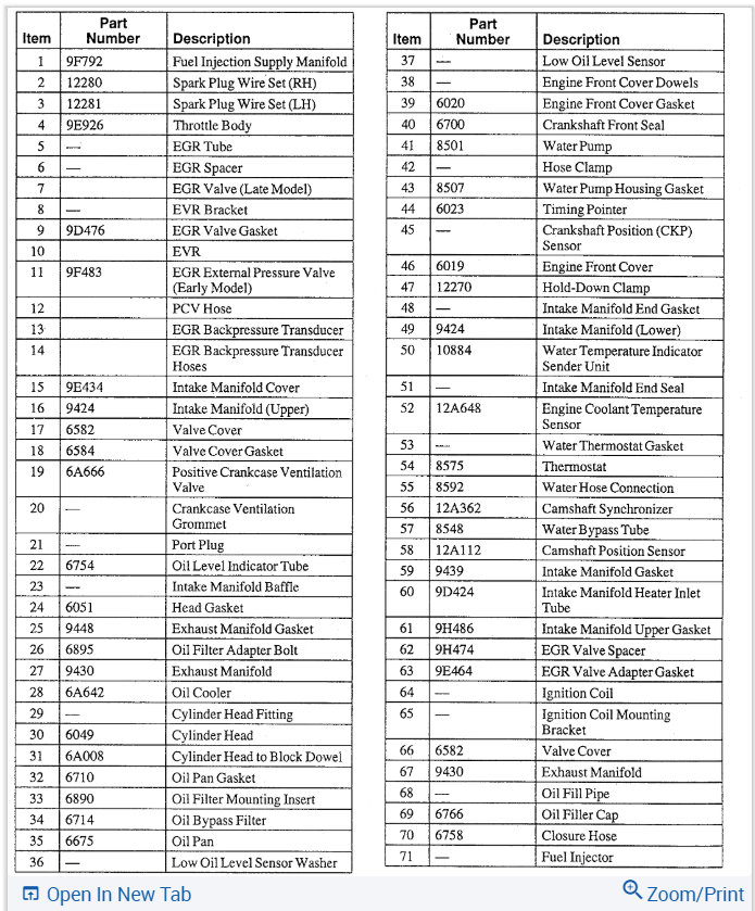

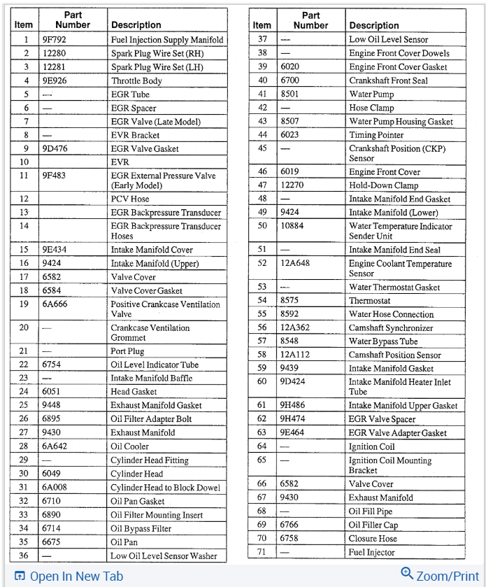

The PCV valve is located at the rear of the engine here are diagrams below to show you the location. Check out the diagrams (Below). Please let us know if you need anything else to get the problem fixed.

Can anyone tell me how to get to the pcv valve on a 2000 ford explorer 5.0 engine

For your 2000 Ford Truck Explorer 4WD 5.0L EFI 8cyl. The PVC is located in the valve cover at the end of the crank case ventilation hose. Here is a picture of what it looks like.
