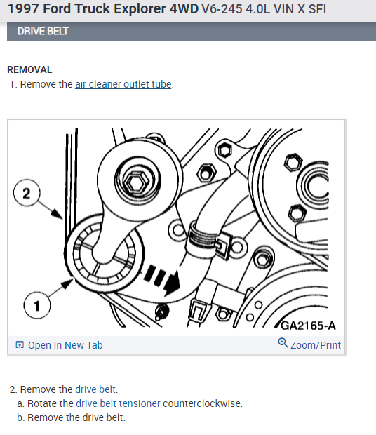

I need to save money but don't know how to change the serpentine belt?
Thursday, September 23rd, 2010 AT 5:48 AM
SQM
  • 6,383 POSTS

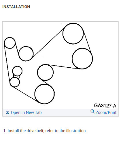

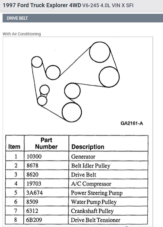

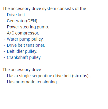

Replacing the serpentine belt on this Explorer is fairly straight forward.
You will be able to do this task using simple hand tools.

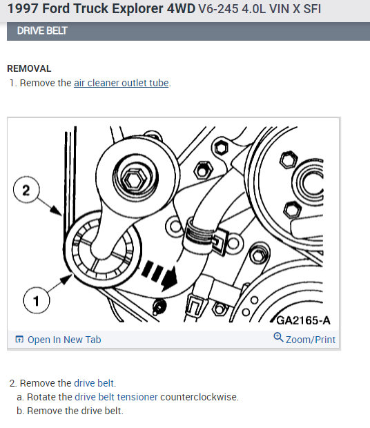

You will have to remove the air intake tubing to get to the belt.
Locate the belt tensioner, using a wrench push the tensioner in the opposite direction of the spring tension to release the tension.
