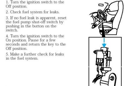

My 1997 Ford Explorer will not turn on. The other day i was dropping off a friend when the ca turns off on me, i tried turning it back on but it didnt. The engine sounded like it wanted gas, but i had 1/2 a gallon. So i think its the fuel pump cutoff swicth, but i dont know where its located? Or if thats the problem? (I checked the fuses and the battery)

https://images.2carpros.com/forum/automotive_pictures/170934_bump_switch_2.jpg
That's all I found for the location of the inertia switch. Have you done any basic testing, like, with the vehicle cranking, check for spark at the plugs?
