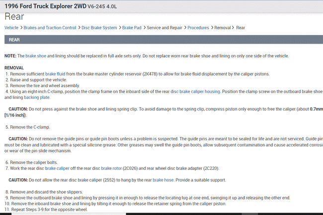

Can someone share with me how difficult it is to replace the rear brake pads and rotors. I've seen other sites and it doesn't seem too difficult, but I get conflicting info, especially when it comes to using a c-clamp to depress the calipers. If some one can give me step by step (with pictures would be awesome) that would greatly be appreciated. I'm not a pro, but I have replaced parts such as oxygen sensors, door locks, and alternators

Replacing rear brake pads and rotors really isn't too difficult to do and doesn't require a lot of time. You will need some basic tools and a safe jack and safety stands to lift and support the vehicle.
As far as rear brakes, you can expect to get approximately 30,000 miles from a set of good pads. However, that can change based on driving habits and terrain.
To get you started, here is a link that explains in general how the job is done. You can use this as a guide.
https://www.2carpros.com/articles/how-to-replace-rear-brake-pads-and-rotors
Also, here is a video showing the job being done. This video covers from 1995 to 2001 Ford Explorers, so it should be a great guide.
https://youtu.be/ETJvQ-XOfJU

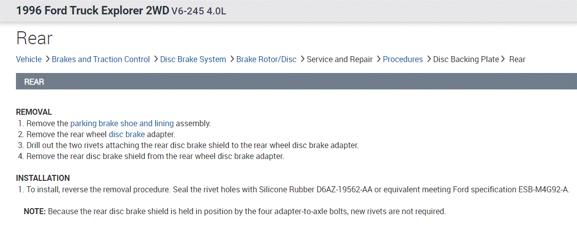

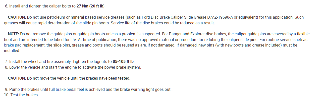

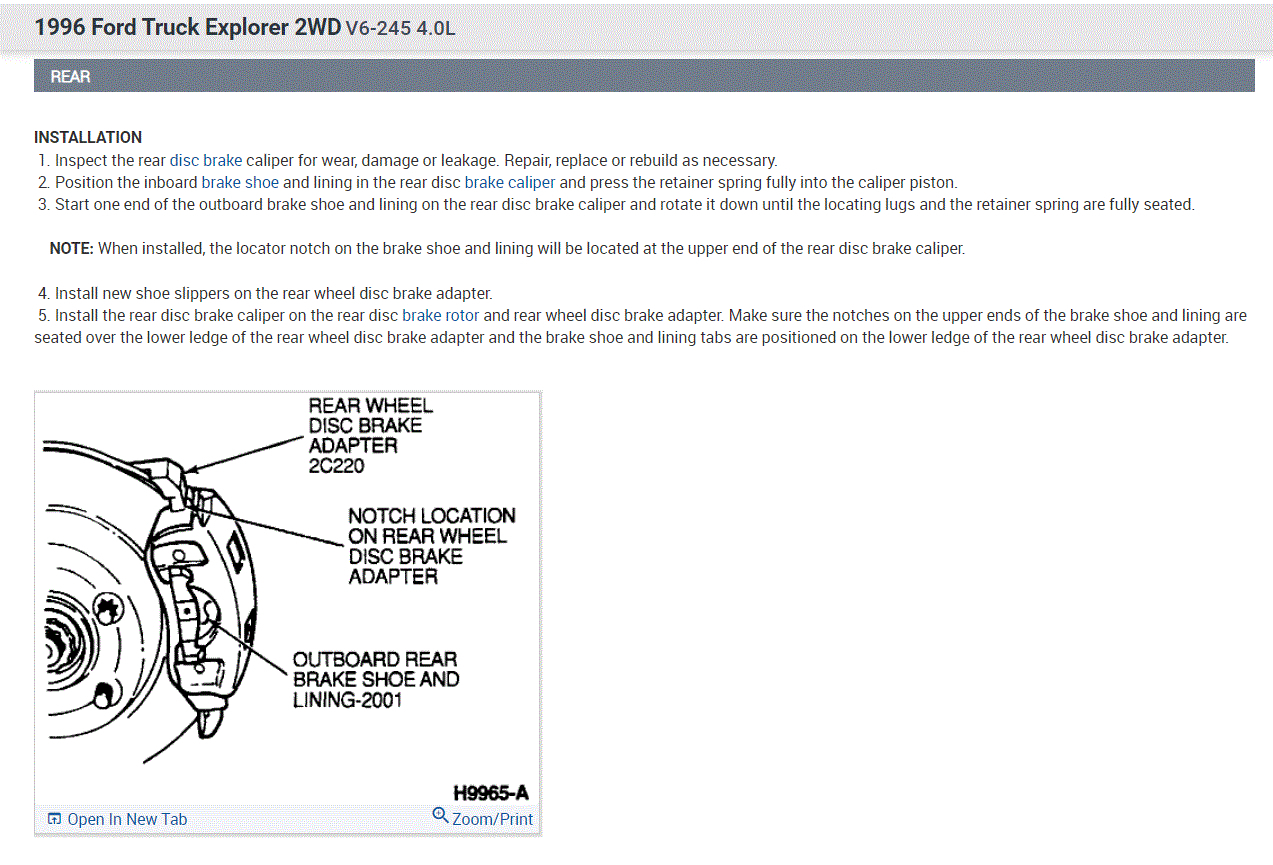

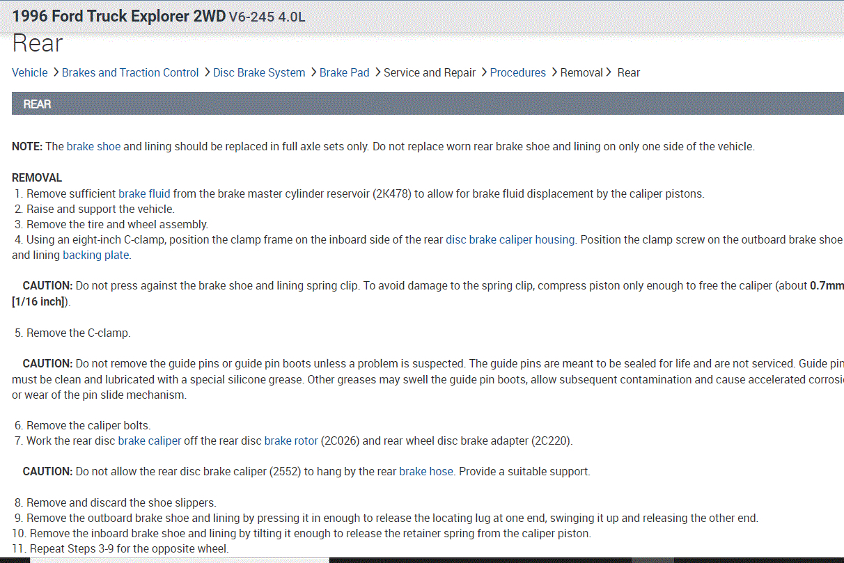

If you look at the attachments below, they provide written directions and pictures specific to your vehicle for rear brake pads and rotors replacement.
