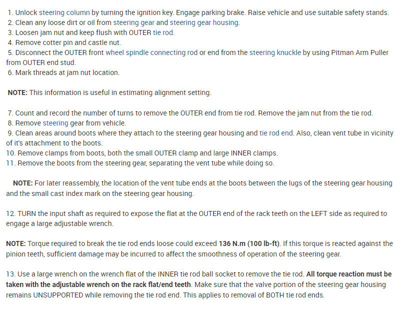

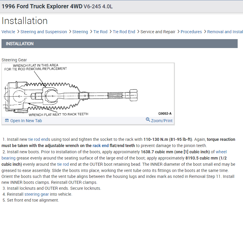

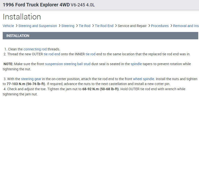

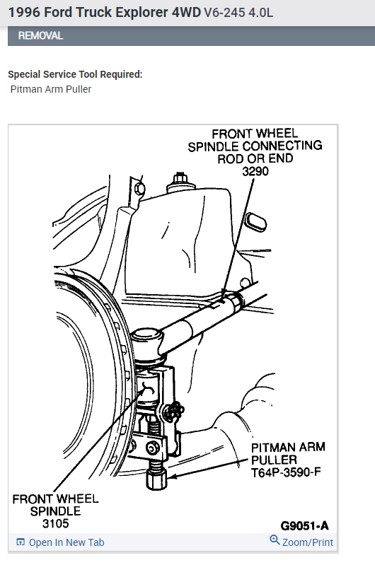

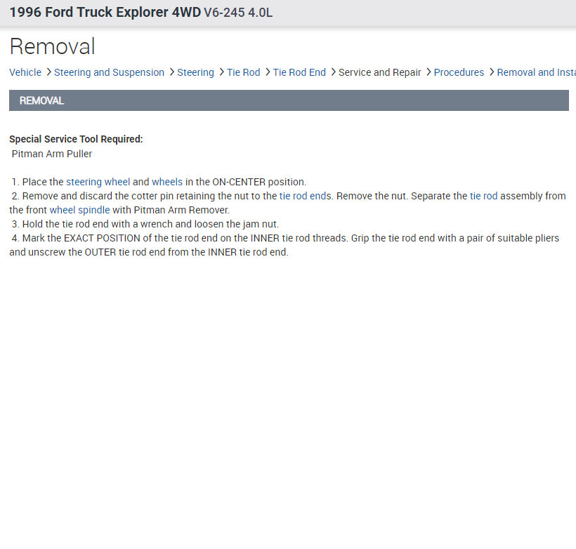

There are few components that can make that noise. It could be the tire rod end. As you turn it makes the noise.
Over time the bushings on the tie rods will wear off and create noise.
Do a visual inspection. Check for excessive play on the joints and also look to any broken or damaged parts.
https://www.2carpros.com/articles/popping-noise
