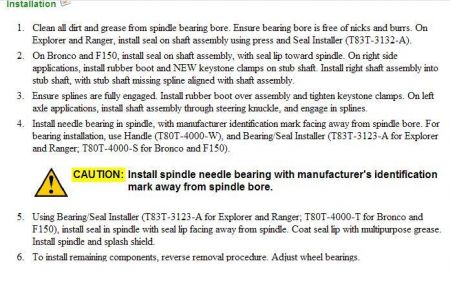

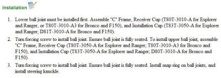

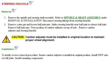

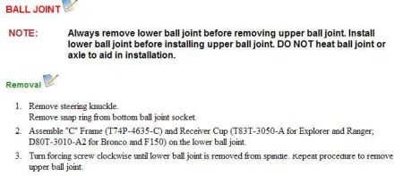

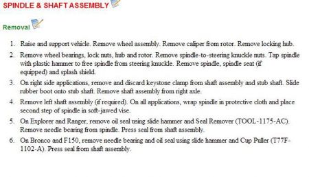

I removed the steering knuckles because a wheel fell off and ground the lower ball joint down to the knuckle. I cut off the castle nuts with a sawz-all and got new ball joints pressed in. How do you get the knuckle back on with the spindle inserted and the ball joints on? It seems like an impossible rubik's Cube. What's the trick?

https://www.2carpros.com/forum/automotive_pictures/261618_Noname_1636.jpg
https://www.2carpros.com/forum/automotive_pictures/261618_Noname2_505.jpg
https://www.2carpros.com/forum/automotive_pictures/261618_Noname3_194.jpg
https://www.2carpros.com/forum/automotive_pictures/261618_Noname4_96.jpg
https://www.2carpros.com/forum/automotive_pictures/261618_Noname5_43.jpg
Wednesday, February 10th, 2010 AT 9:27 PM
