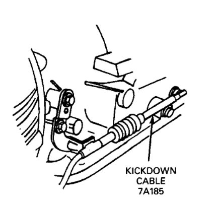

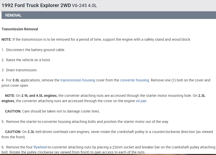

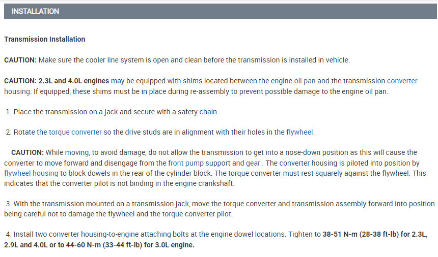

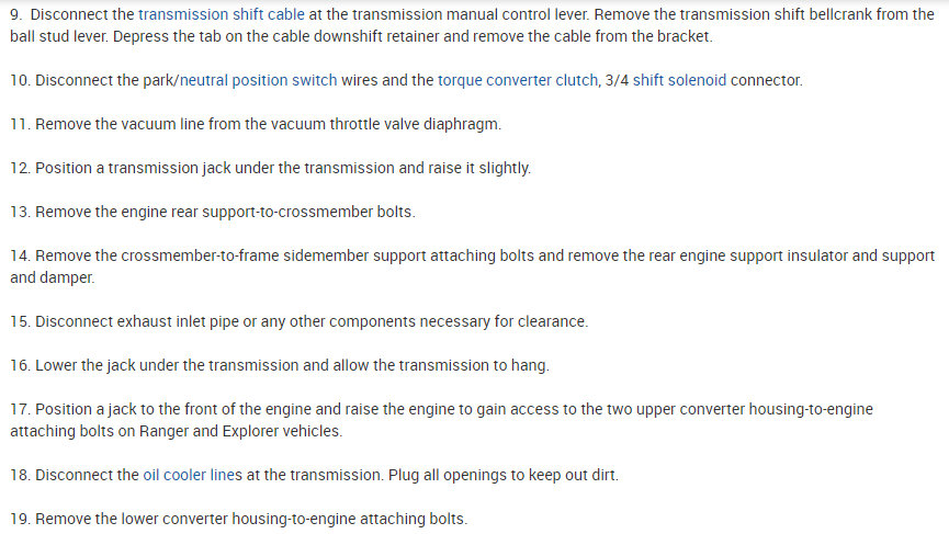

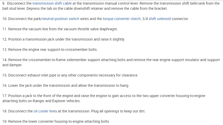

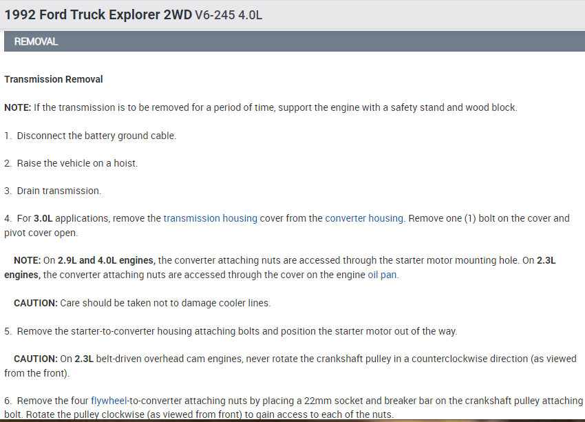

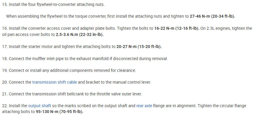

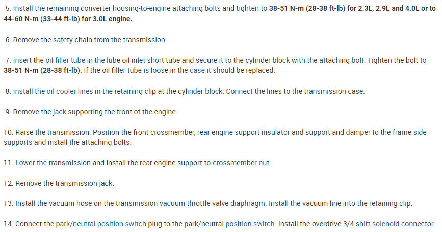

While driving along in my car/truck, I stopped at a red light. When the light turned green, I tried to go but my truck would not move. It will drive backwards, but it will not go forward. Please tell me how to remove the transmission.
Saturday, June 14th, 2008 AT 3:17 AM
DANNY L
  • 5,648 POSTS

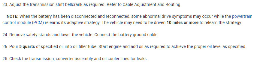

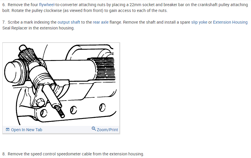

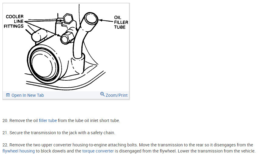

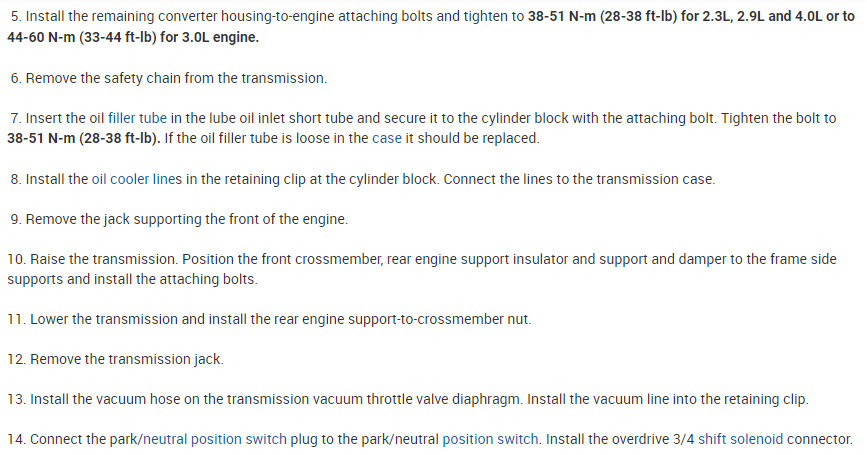

Hello, I'm Danny.
Here is the information you requested. This is a tutorial showing how to remove and replace a manual transmission which is similar:
https://www.2carpros.com/articles/transmission-replacement-removal-manual
I've attached picture steps below on how to remove and replace the automatic transmission on your Explorer. Hope this helps and thanks for using 2CarPros.
