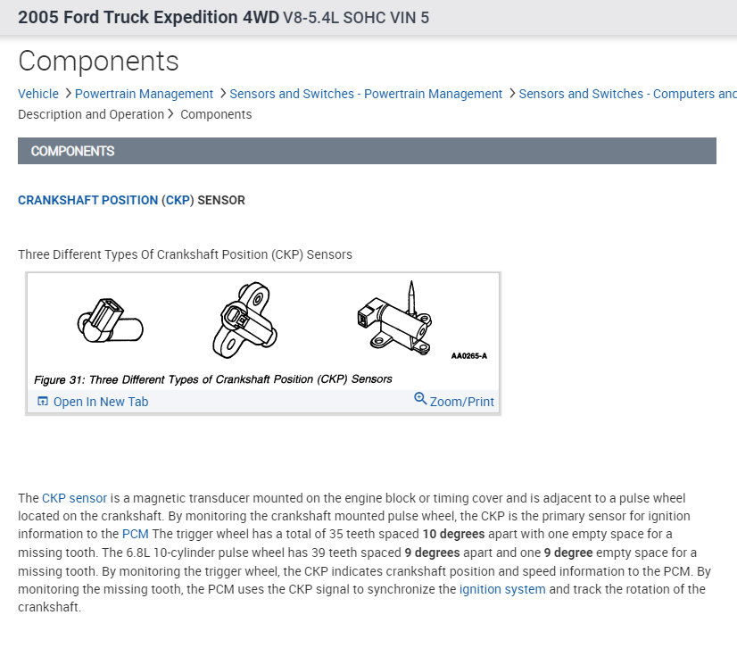

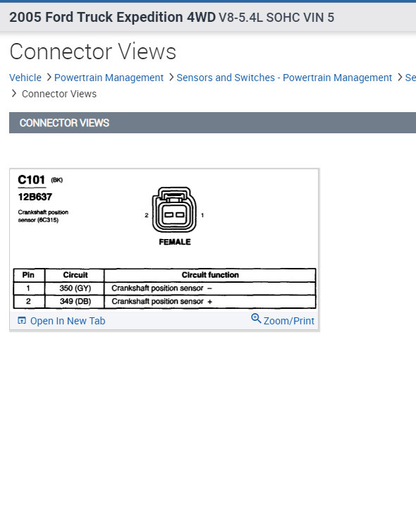

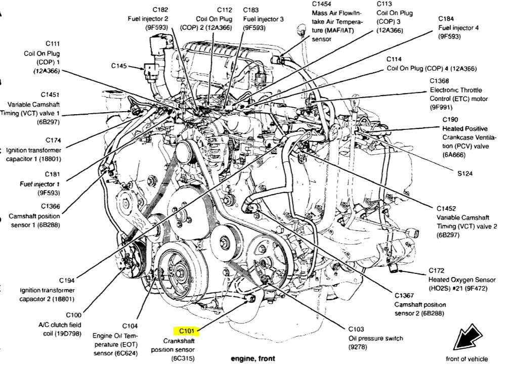

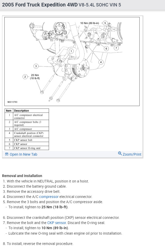

This engine shut down could be due to a faulty crankshaft position sensor.
The crank sensor monitors the engine revolution and sends that data to the ECM. Over time the heat and vibration from the engine the sensor can lose its internal calibration and send error data to the ECM. This can trigger an engine shutdown.
