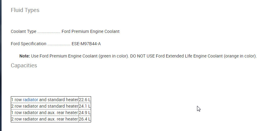

What type/color is used in my vehicle listed above? Does it matter green or orange?
Friday, April 3rd, 2009 AT 2:35 AM
It does matter for your vehicle. There are many aftermarket coolants that say they are compatible with everything but I never trust them when the OEM says to use a specific one as yours does. Please see the attachment for the detail and let us know if you need more info. Thanks
