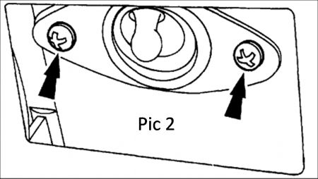

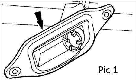

Well, no luck there so far. I called around to all the salvage yards and no one had any. I am still out of luck.......but I was wondering about your answer and need a little more clairification. You say to "Just remove the two screws and plug in the connector, you're don" where are these 2 screws located at? I don't know what I am looking for. Are these way up under the trunk? How far to reach to get to them? Am I needing to also replace the wiring assembly ? I don't know if the wire assembly is bad too. All I know is the 2 light bulb fixtures are bad.
One of the guys at the salvage yards said I needed the housing for it but didnt say if the wire assembly came with it or what.
Please help! I can't drive my car after dark because of this and I am risking a ticket.

IMPALASS
  • 3,112 POSTS
Hello - Which one of the pics are you needing.....Pic 1 or Pic 2
https://images.2carpros.com/forum/automotive_pictures/248015_Picture1_41.jpg
https://images.2carpros.com/forum/automotive_pictures/248015_Picture2_31.jpg
Dec 28, 2008 at 1:55 PM
TONYA_1518
  • 8 POSTS
Oh wow thats nice for you to display a pic. Its more like PIC 2. Would a 1997 or 2000 model work? I hope to hear from this soon, Thanks so much for your help, I appreciate this so much! Tonya
Jan 2, 2009 at 11:03 AM
IMPALASS
  • 3,112 POSTS
Hello –
By the pics I see – it looks like a 1997 or 2000 is the same. To be sure you can contact the parts department at the dealer and ask them if the part numbers are the same for a 1997 and 2000 as the 1998…..if they are you are in.

Hi all, Well I finally am getting it fixed and it looks like for only $ 8.00 !!
I took it to an auto supply store and they looked at it and pulled the old bulbs that were stuck inside there out and I put in the new bulbs and got one of the lights working. He told me I needed the housing for the one that didn't work and they didn't carry it so I called Ford dealership and they said the housing actually comes with the socket and wire, so I ordered 1. I am going to take it to my brothers and have him install it for me, so In all, this only cost me a small amount compared to what I thought it was going to cost me.!!
