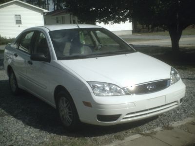

i would like to know which vehicle you think will be best for me because i am looking something for gas mileage, good cargo room, and that will not break down on me. i am a senior in high school, and iam leaving for college this summer which is a 3hr drive from here and i will be coming back home almost every weekend, which do you think will be the best car for me. i was saying a focus was good because i did own one but i wrecked it becasue some dumbbutt pulled out in front of me.
https://images.2carpros.com/forum/automotive_pictures/58876_SUNP0022_1.jpg

Not that I have a problem with a focus per se, I have a problem with spending money foolishly. A new car does not mean problem free, it does mean gaurenteed payments or a high cost per mile to drive anyways. I have had several customer's that wanted to get away from their old "undependable" car, and buy a new one to find out differently. With a new one you are locked into the dealer for problems because of warranty. Since it eliminates competition combined with the manufacturer's pressure to keep claims down, the service falls off. This causes a longer down time, difficult scheduling and no gaurentee of "no charge".
Case in point, One customer we had needed brake rotors, and it was under warranty, Because the pads had to be done at the same time the dealer charged him for labor and pads. It cost him more to have it warrantied than it would have if we did the whole job!
Recently, (and you will find these type ofcases on the forum) cars that are in the warranty period, but the dealer can't solve them (focus being one) or the many cases of problem. Saturn no-start, impala power steering lines that blow, the list goes on.
I wouldn't spend more than $5000.00 on a car if I were you. Personally I like hondas. Pay a mechanic check it out thoroughly before you buy it.
