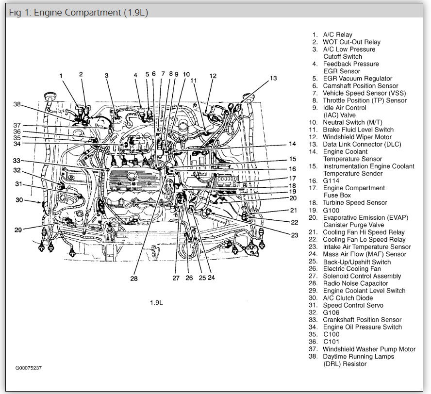

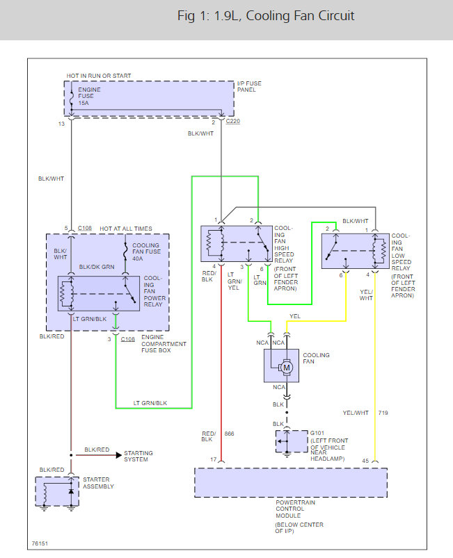

Test out your Cooling Fan Power Relay, located on the top of left front wheel well, in the engine compartment fuse block. Here is a guide to help you test the relay and the fan wiring dagis so you can see how it works with the relay location. I would also check to see if the fan motor is not burnt out here are two guides to help.

I located and tested the fan power relay but I am not sure about where the cooling fan relay is. There are two green relays next to each other that are 40 amp. I switched them and they still worked the same. Any other suggestions for why my fan will not come on?

Check 15-amp engine fuse in the interior fuse panel. Also test 40-amp cooling fan fuse in the main fuse junction panel. Let me know if either fuse is blown.

Neither fuse is blown. Thanks for all of your help. I am still not able to locate the relays that I need to check. I thought I found them, but I "think" they were 40 amp fuses and not the relays. Can you help me better understand what and where to look for the relays and how to test them easily? Thanks again, and sorry for any confusion, since I am just a backyard mechanic trying to save a couple bucks.

Okay, it will be located inside of the engine fuse block (circled below). It will have either part # F02Z-14N089B OR # E92Z-14526C. This is the best way to make certain you find the correct one. You can learn how to test a relay on our "How to Repair or Service" page , linked below..
https://www.2carpros.com/how_to/how_do_i_check_a_relay.htm
The relay should look similar to the picture below and will either have 2 or 4 prongs, the color may differ though.
https://www.2carpros.com/forum/automotive_pictures/261618_Noname2_176.jpg

I wish I checked the fan motor earlier I got a new one now everything works. :) Sorry
