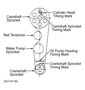

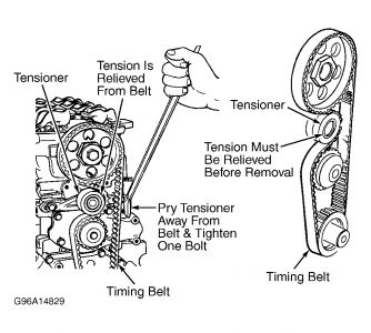

Is it easy to change a cam belt and how do you do it

Rotate crankshaft and align timing mark on camshaft sprocket with timing mark on cylinder head. See Fig. 1. Ensure crankshaft sprocket timing mark aligns with oil pump housing timing mark.
Loosen belt tensioner retaining bolt. Pry belt tensioner away from timing belt and tighten retaining bolt. See Fig. 2. Install mount at timing belt end of engine to support engine.

Fig. 1: Aligning Camshaft & Crankshaft Timing Marks
Courtesy of FORD MOTOR CO.
Fig. 2: Releasing Timing Belt Tension

Loosen belt tensioner retaining bolt. Allow belt tensioner to apply tension on timing belt.
Rotate crankshaft 2 full revolutions clockwise and realign timing marks. DO NOT rotate crankshaft counterclockwise. Tighten belt tensioner retaining bolt to specification. See TORQUE SPECIFICATIONS.
