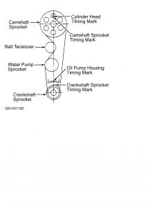

When facing the engine, the timing belt is under the black cover on the left side, right? I would have expected other symptoms before the timing belt failed. Would it have just failed without warning?

BMRFIXIT
  • 19,053 POSTS
Do u have fuel ?
is the fuel getting to the filter ?
if not check fuel pump remove the rear seat and check if the pump working check for power
if u have power and no fuel suspect fuel pump
timing belt is behind the plastic cover in the front of engine
https://www.2carpros.com/forum/automotive_pictures/99387_escort_timing_3.jpg
