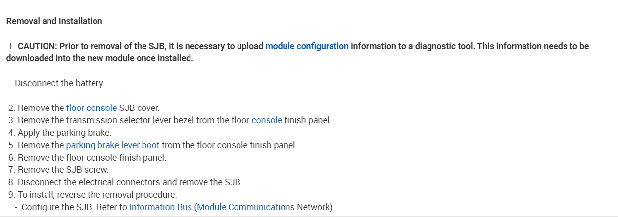

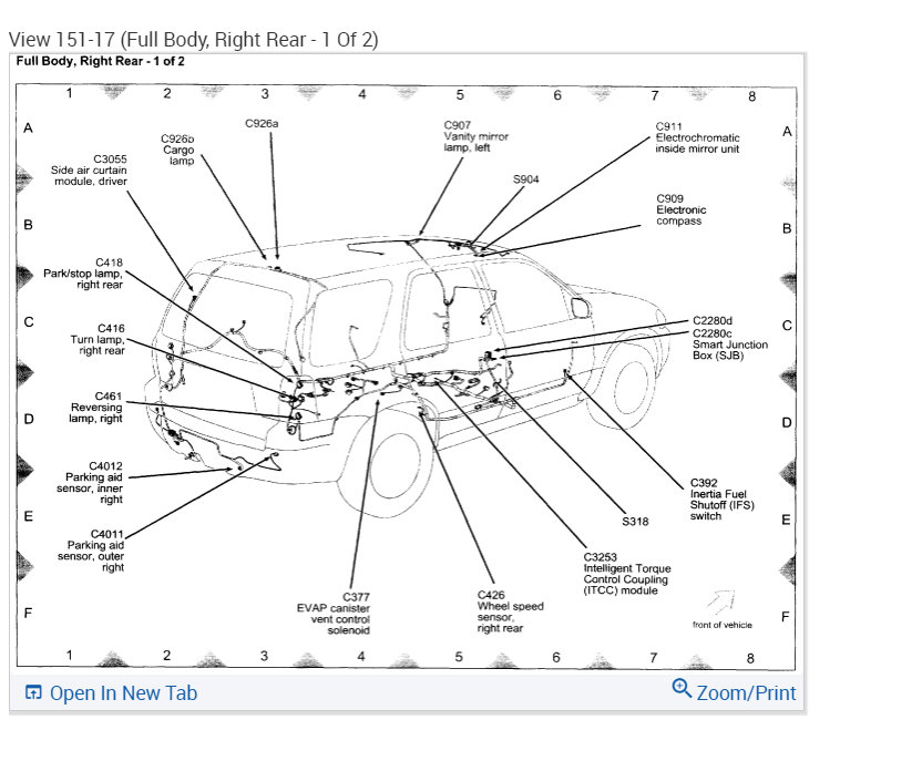

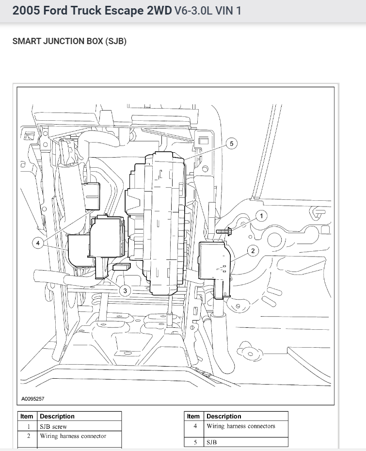

Good to hear, let's fix it. The relay you hear clicking can be a clue to the problem, but I would like to scan for codes because an engine misfire can cause the problem as well. Are the spark plugs etc., fairly new? I have seen ignition coils go out as well. Anyway, sometimes a code will not be set if the problem has just started. Let's follow these guides and I have included the SJB (smart junction box - BCM) that I think might be the problem if everything checks out. These go out a lot.
and
This guide can tell if the SJB is going bad.
Jun 17, 2022 at 4:55 AM
