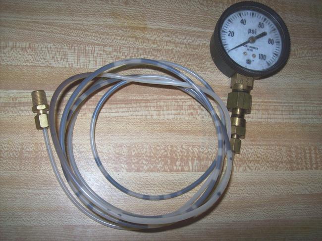

If you are experiencing funny noises or knocking at low pressure for sure, it is probably serious! Something you did mentioned here, is have you checked your oil level. It is important to check it at minimum, "weekly" as probably prescribed in your owner’s manual and also if you suspect a problem or your gauge or light says you have a problem! Anything could happen within seconds, your oil plug falls out (installed wrong) or road debris knocks a hole in your pan! If oil is the issue, immediately shut it down!!!....no limping it another 500 feet! Remove your oil pressure sender and install a mechanical oil pressure gauge. This will give you a real accurate reading as to what your actual oil pressure is, and is doing while being driven.
A gauge set up sort a like mine, or an aftermarket under the dash mount (used as a portable, temporary test platform) will allow it to be run out from under the hood and into your window, so you can watch it as you drive, on top of the dash, or in the seat beside you.....might pick out a pertty one, you may want to mount it permanently and do away with the electric one,
