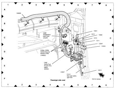

Where is the remote keyless entry receiver located on a 2004 Ford E350?
Oct 1, 2010 at 9:39 AM
WRENCHTECH
  • 20,761 POSTS
It's behind the kick panel on the passenger side.

Thank you ! This is a huge help to me. I am going to assume the receiver is the VSM. Do you think I can just change the doors, plug them in to the existing harness in the 2005 and the remotes will work? Maybe I will have to program the remote fob to the 2005 VSM ? Thank you so much for responding!!

Yes, the VSM will need to be programmed to your car. here is how:
CAUTION: All remote transmitters must be programmed at the same time.
1. The vehicle must be electronically unlocked before entering program mode (via remote transmitter, keyless entry keypad (if equipped) or door lock control switch while the driver door is open.
2. Turn the key from OFF to RUN 8 times within 10 seconds, with the eighth turn ending in RUN. If the module has successfully entered program mode, it will lock and then unlock all doors.
3. Within 20 seconds, press any button on a remote transmitter, and the doors will lock and then unlock to confirm that each remote transmitter has been programmed. Repeat this step for each remote transmitter.
4. If the door locks do not respond for any remote transmitter, wait several seconds and press the button again. If the door locks still fail to respond, refer to Inspection and Verification. Make sure that no more than the maximum number of remote transmitters are attempted to be programmed.
5. Exiting the programming mode is accomplished if one of the following occurs:
- The key transitions to the OFF position.
- 20 seconds have passed since entering programming mode or since the last remote transmitter was programmed.
- The maximum number of remote transmitters have been programmed.
