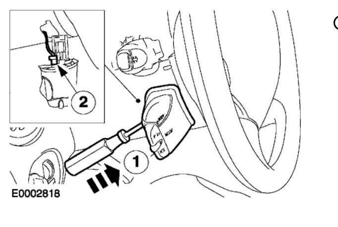

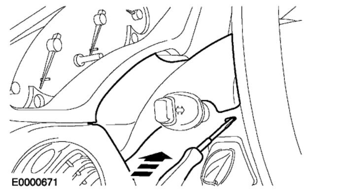

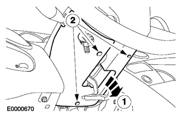

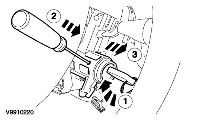

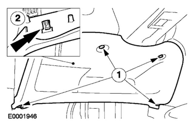

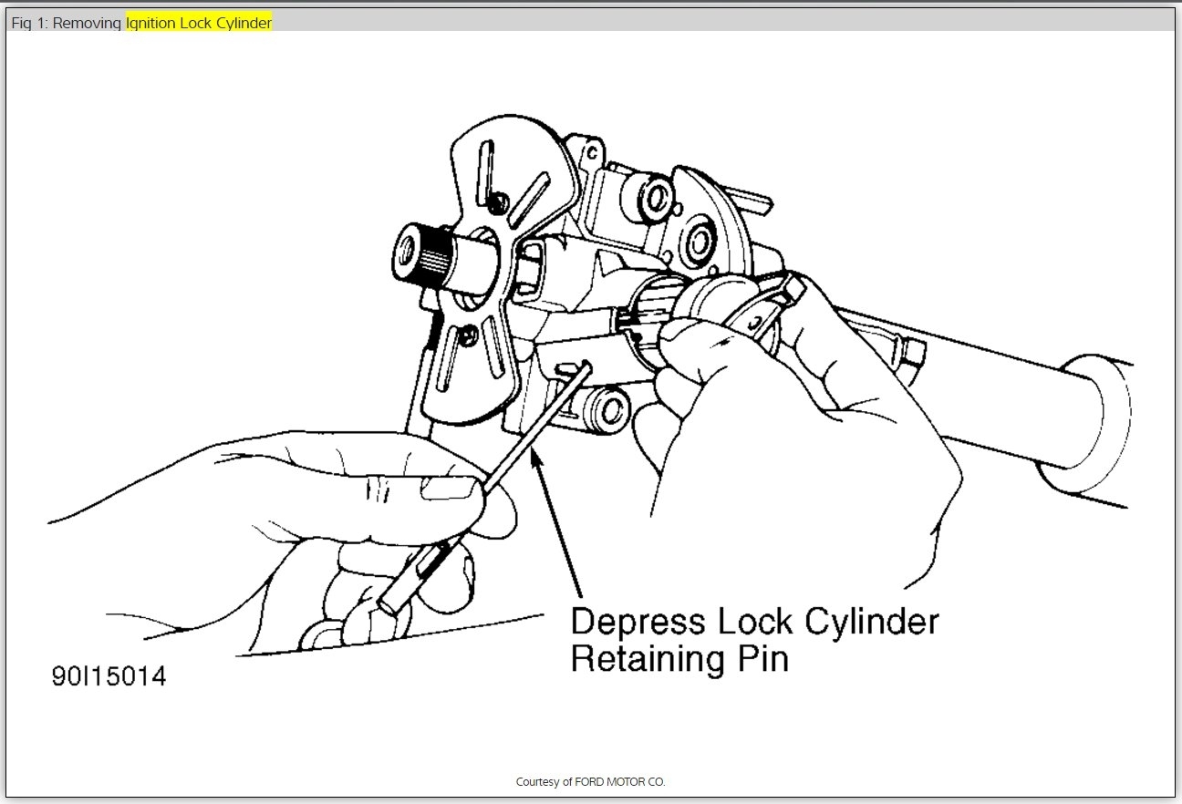

It sounds like the ignition lock is broken, here is how to change it out. Check out the images (below). Please let us know what happens.
