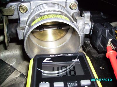

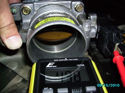

I cleaned the MAF with CRC Mass Air Flow Cleaner.
I checked voltages with key on. I am attaching the pictures. No I do not have a check engine light.
https://www.2carpros.com/forum/automotive_pictures/416038_TPS_Wide_Open_2_1.jpg
https://www.2carpros.com/forum/automotive_pictures/416038_TPS_Closed_2_1.jpg
Wednesday, September 15th, 2010 AT 6:37 PM
  • 75,992 POSTS
You have a problem with the TPS it should not have that voltage 4.98 volts. It should be below one volt at closed throttle position and gradually increase as you smoothly rotate the throttle to that voltage 4.98 volts.

I know that the TPS should also have.8 to 1.0 Ohms and I only get.003 Ohms. I have the meter set to 2M for resitance is this correct setting for the multimeter?
Also, are the probes in the correct position on the TPS plug? I have the black on ground and the red on VOL REF. But why would this happen when all I did was change the IAC valve?
Wednesday, September 15th, 2010 AT 6:58 PM
WAY2OLD
  • 195 POSTS
The reference wire is a five volt wire. You are reading the correct voltage. Move the red lead to the signal return wire and the black to a good engine ground and see it the voltages fall in range. Look at the IAC to be sure the gasket is not the fault and leaking air by it to the engine.
Wednesday, September 15th, 2010 AT 7:18 PM
LANCE43
  • 14 POSTS
I checked the voltage with the red probe on the TPS signal wire and black to ground. Moving the throttle the voltage went from.96 volts to 4.70 volts.
I put gasket sealer on the valve before installing it. I cannot tell if its leaking or not with the engine noise.
I have been told that if the IAC is humming that means it is bad, is this true?
Wednesday, September 15th, 2010 AT 7:37 PM
  • 75,992 POSTS
The TPS is good, unplug the IACV if it quiets down, replace it.
