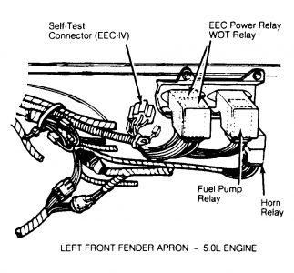

i have a 1989 Ford Crown victoria 5.0L. My problem is the my fuel injetors arent opening. Got gas going to the injetors but they wont open. If I spray startin fluid it runs for a sec then stalls.

You have verified fuel pressure is correct and then used a noid light to verify the injectors arent working?Do you have power at the injectors?

Got no power got to the injectors. Got power on my coil packs but no power goin to the injectors

Check for power at the EEC relay Orange/black wire.If you have power there then there is a wiring issue between there and the injectors.Mitchell doesnt show any fuses for that circuit, but I would check every fuse with a test light anyway, these wiing diagrams arent always 100% accurate.All of the red wires are powered from the same source.
https://www.2carpros.com/forum/automotive_pictures/1639_Graphic_12.jpg
