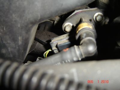

1999 Ford Contour Where is the fuel pressure regulator located at on the 2.0L 4 cylinder engine. It's supposed to be on the top by the throttle body but it's not. There is a sensor of some sort on the end of the fuel rail with a connector, fuel line and vacuum line attached to it but it doesn't look like the fuel pressure regulator that ford or any other manufacturer displays.

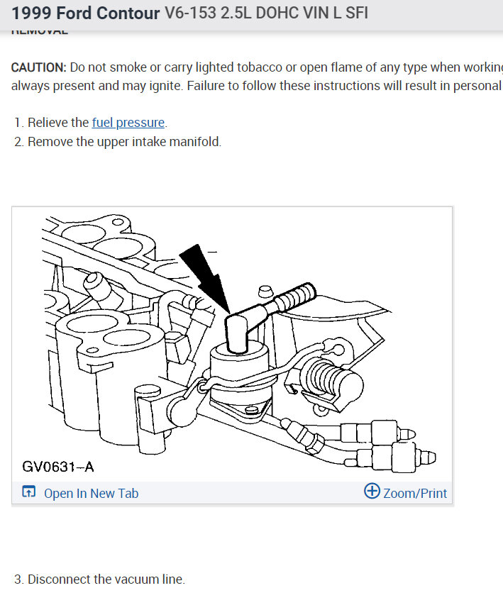

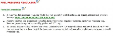

HI there,
The fuel pressure regulator in on the fuel rail. Check out the images (below). Let us know if you need anything else.

I have seen that picture many times. My haynes manual shows the same part as well as Motorcraft website. I know what the fuel pressure regulator is supposed to look like but it's not there! I guess what I'm trying to say is that there is no fuel pressure regulator located on the fuel rail or anywhere else on the engine. Is that possible with this particular vehicle? Did they make different fuel rails for the 2.0L engine in the 1999 Ford Contour?

Hi there, You have me stumped, the pressure regulator should be on the back of the fuel rail,
https://images.2carpros.com/forum/automotive_pictures/61395_Capture_66.jpg
This is from Mitchell 1 data base, now it isn't a dedicated LPG fuel car is it? silly question but it is still a petrol engine? if it is not there i just do not know why, there is no other place for it to be, is there any spot on the fuel rail to accept it? has it been removed and the port blanked off? that is about all i can think off. mark (mhpautos)

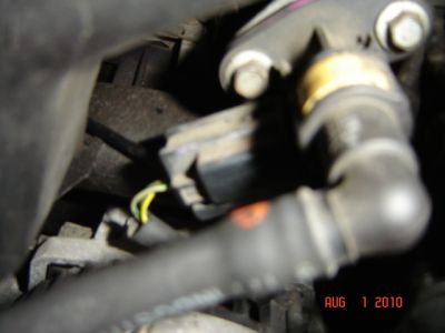

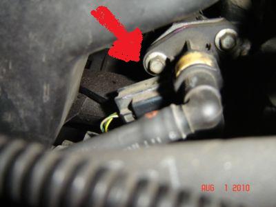

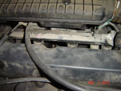

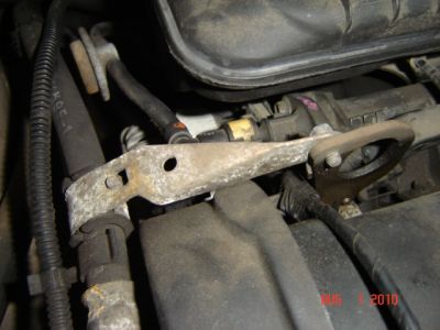

Here are the pics you requested. The part in question is on the right end (passenger side) of the fuel rail. You'll also notice form the other picture from the top of the engine that where the FPR should be there is none. I really think someone at some point replaced this fuel rail with a different model. Even the fuel line coming in is at the wrong location. Let me know if the pics are viewable. Thanks for your help!

Electronic returnless fuel system does not use a fuel pressure regulator. Electronic returnless fuel system uses a Fuel Rail Pressure (FRP) sensor to sense fuel pressure. FRP sensor is located in fuel supply manifold assembly. FRP sensor input signal is used by the PCM to vary the duty cycle output to the Fuel Pump Driver Module (FPDM) to compensate for varying loads. FPDM then modulates voltage to fuel pump to achieve proper fuel pressure. Engine Fuel Temperature (EFT) sensor input signal is also used by PCM to vary fuel pressure to avoid fuel system vaporization. Arrowed is the FRP
https://images.2carpros.com/forum/automotive_pictures/266999_contour_1.jpg
Hope this helps

Thanks Dave for explaining that for me. I wish they would show or explain that in the manuals but they do not mention this in any of the manuals I've read. Do you think this could be the culprit with my fuel issue? Also Where should I hook up my fuel pressure tester to even check fuel pressure? I really think it's a fuel starvation issue and not an ignition problem. If I could hook up the tester I could certainly narrow it down quicker than the route I'm going now, which is basically the guessing game.

It doesn't have one. It is a variable voltage system controlled by a computer.
