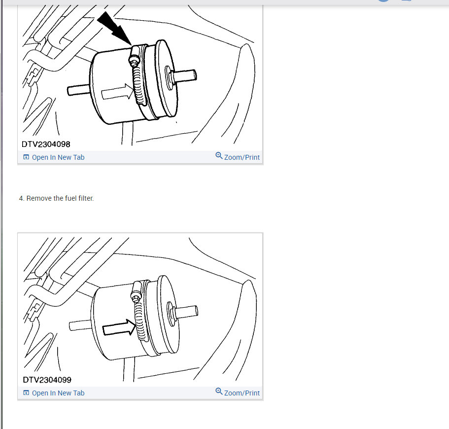

I would suggest with starting with checking the fuel pressure before we get to far down the line. Here is a guide that will help with doing this:
If the pressure is low then we can check the filter and make sure it is not plugged. Otherwise you are going to most likely have a pump issue.

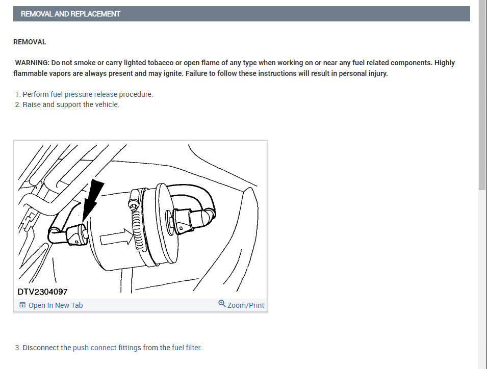

Here is a guide that will help with replacing the filter:
https://www.2carpros.com/articles/how-to-change-a-fuel-filter
Please find the process from the manual below that will help with replacing the filter as well. Let us know if you have questions or issues and we can go from there.
