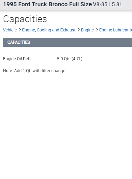

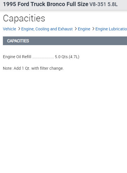

You can you either of those oil.
However, the high mileage oil will have extra additive which makes it more resistive to sludge buildup. It can also condition the engine seals. It can also reduce general wear and tear.
Both of the 5.0L and 5.8L V8 uses 6 quarts of oil.
