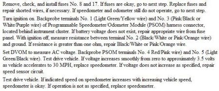

these symptoms all point to a faulty speed sensor, since this is what is used to operate the speedometer and also sends signals for use of the transmission. the speed sensor is located on the rear axle.
Dec 29, 2009 at 1:34 AM
I HATE DON
Thanks for the response, at least now I have a direction to look towards. The odometer is digital and stopped working when the speedometer did, the speedometer is a needle type. Is the speed sensor on the rear axle a job I can do myself ? Where on the axle will I find it ? Will I need to re-calibrate the speedometer when I change out the sensor ? Could this be causing the intermittant on and off of the ABS light ?
Dec 29, 2009 at 8:54 AM
BLUELIGHTNIN6
  • 16,542 POSTS
https://images.2carpros.com/forum/automotive_pictures/261618_Noname_1357.jpg
