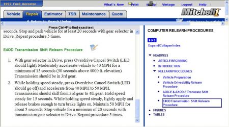

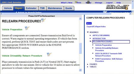

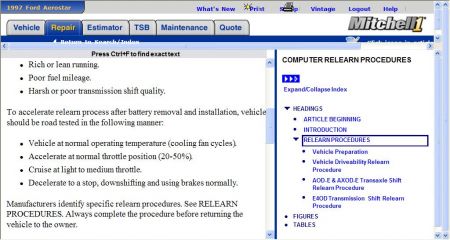

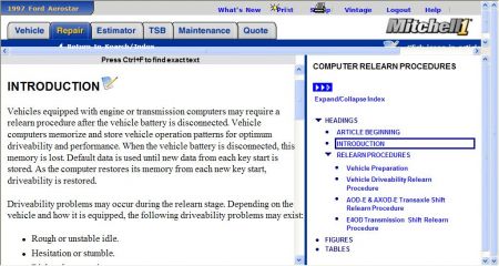

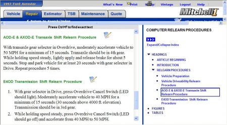

For a start lets try computer relearning due to you've disconnected the battery to get to the alternator.
