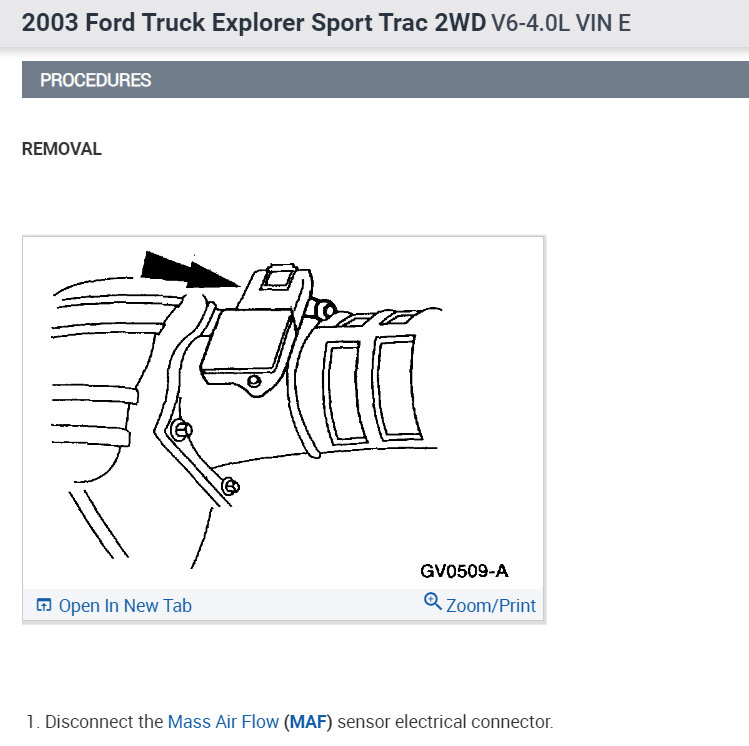

Intermittent issue of shutting off while driving?
2003 FORD EXPLORER SPORT TRAC
130,000 MILES
KODIAK1322
Idle changes between 900 and 2,000 RPMs. Sometimes the engine shuts off but starts right back up. I changed the idle control valve; spark plugs and fuel filter. It will sometimes shut off while driving down the highway but starts right back up.

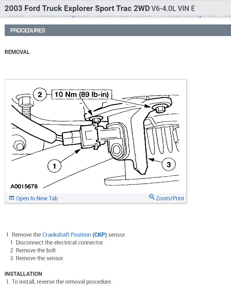

This can be many things, but I have seen the crankshaft angle sensor cause this problem without triggering any trouble codes, please check out this guide and I have included the location for the crankshaft angle sensor in case you want to swap it out. I have also seen the MAF short out as well causing this problem
https://www.2carpros.com/articles/engine-stalls
and
Check out the images (below). Please let us know how it goes
Jul 3, 2023 at 10:08 AM
KODIAK1322
The maf fixed it. Thank you for your time.
